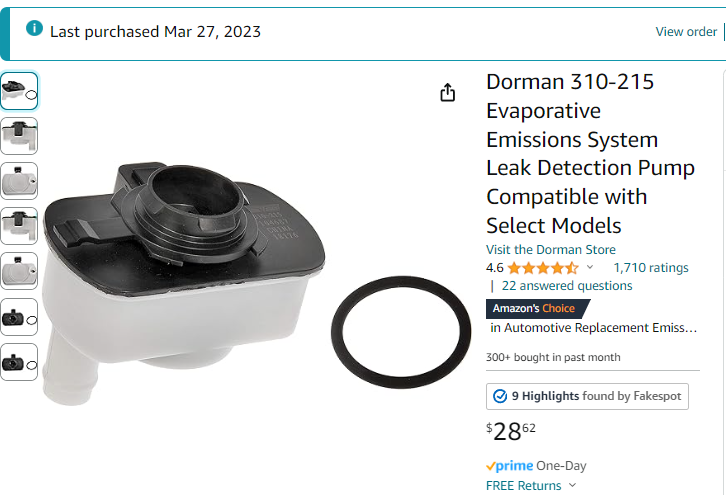

I fought this for a long time myself. I believe that more often than not, it's the control module itself on the evap canister. It's a cheap part that is easy to replace. I would swap that first before further troubleshooting. I just used the Dorman unit and have had no further issues since March (my jeep is a '13 as well so that factory one was 10+ years old) -
