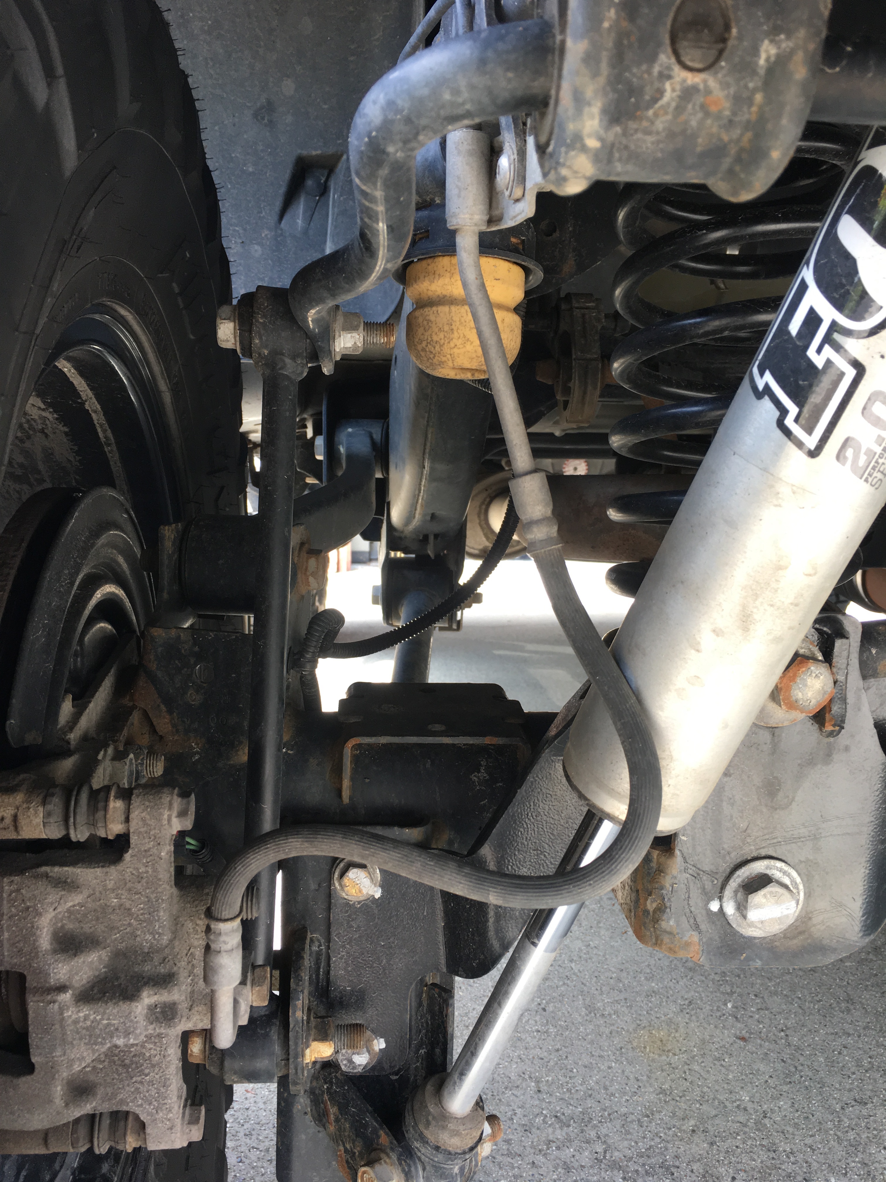

Can someone identify if these sway bars are from Rock Krawler flex system? I had a 3.5 rk flex system installed and these sway bar installed in my jeep doesn't look the same as in the picture of an RK system. Thanks Click image for larger version

Those are definitely not RK sway bar links. Hard to tell from the pics....the front ones look like they might be the stock rears....and the rears some aftermarket patched from a different kit or budget boost. On a side note, you have no bump stops either front or rear.....presume by design. If not by design, might want to read up a bit on that.

Thanks for responding. So I contacted the shop who did my install and they are saying that their supplier sent them last years model of the RK flex system and that they were not aware. They are saying that these adjustable front disconnect links were added by RK this years model. Im not sure if I believe them totally but I'll take their alibi.
I just realized they didnt even install the stainless steel extended breakline for the rear..

That shop is F'ing you over. Those are not even an old model rk links, and if they didn't install the break line either...... Odds are they keep em and try to sell. Em for a few extra bucks to someone. I would first take some good pictures of the links, send an email to RK and ask if they can identify them just so you have written proof to show the shop...... Right from the manufacturer, and hold their feet to the fire on that and your brake lines. I'd look at your springs and make sure they have the RK part numbers stamped on em. You should see it in white text.... I believe closer to the top.
