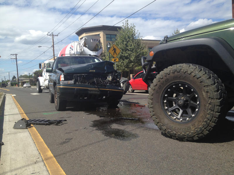

I was driving down a one way and noticed someone coming the wrong direction. The idiot was high out of his mind and hit me head on. Thanks to my smitty built bumper the front end didn't crunch, but there was some frame, fender, suspension, and ball joint damage. To what extent Leif's wouldn't communicate to me...

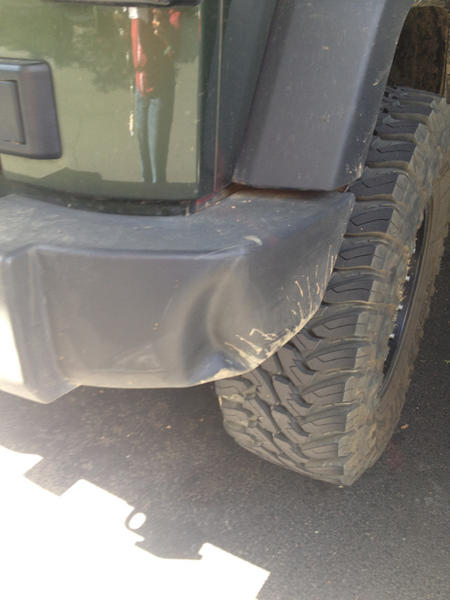

I took it to Leif's auto body who claims they are #1 in the NW however the shits not fixed right at all, and I can't seem to get them to return my phone calls. I have horrible death wobble now, I feel my jeep is all over the road. The left fender isn't aligned properly and I still feel my bumper is slightly pushed in, even though its brand new it doesn't line up right.
Any suggestions would be greatly appreciated. I just want it back to normal.
My Jeep
His jeep
Front end before repairs...
My Jeep
His jeep

Well I finally got both the insurance company and auto body shop to meet with me Monday. They put me back into a rental and said they'd figure things out. Fingers crossed they fix it proper this time.
They said the reason the bumper didn't look straight was probably because the body shifted on the frame. They couldn't give me a reason as to why the fender wasn't aligned properly, but would look into it.... aaaand they blamed the death wobble on the dealership they supposedly took it to. I told them I didn't care who did what, but all that I ask is it get fixed like it was supposed to have been.
Patiently waiting....
