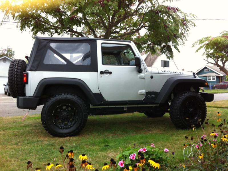

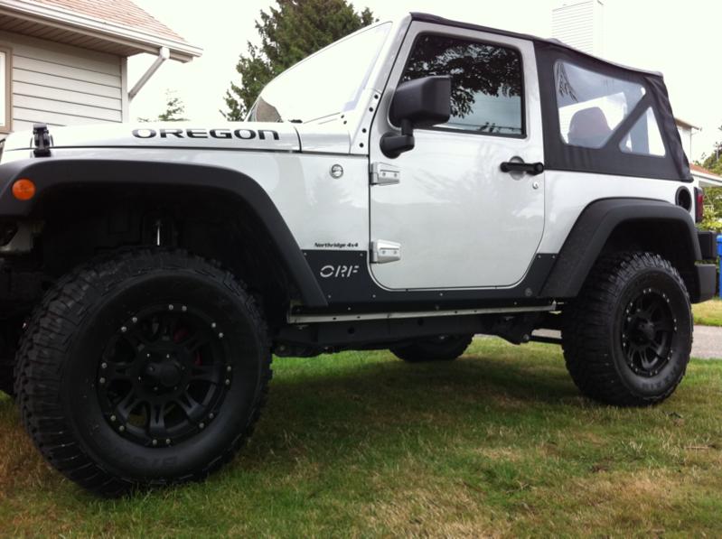

Thanks again Bob. Had a blast. I have plenty of mods down the road I'll need help with, so at least you will have the same 2dr to work on. ;-) the liquid metal worked well on two of the holes and some stainless self tapping screws worked pretty well. It's pretty solid.
Til next time mah friend!
