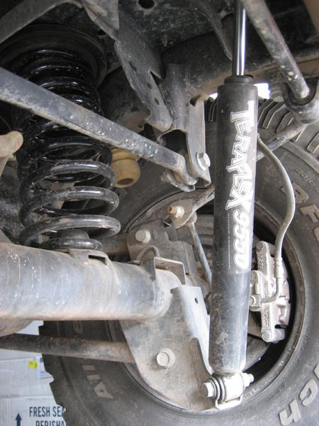

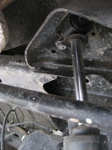

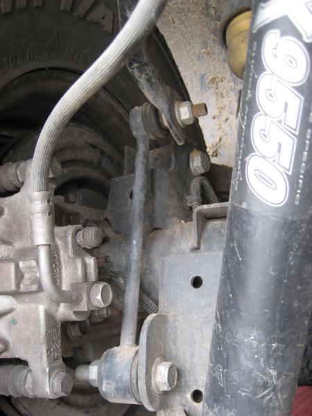

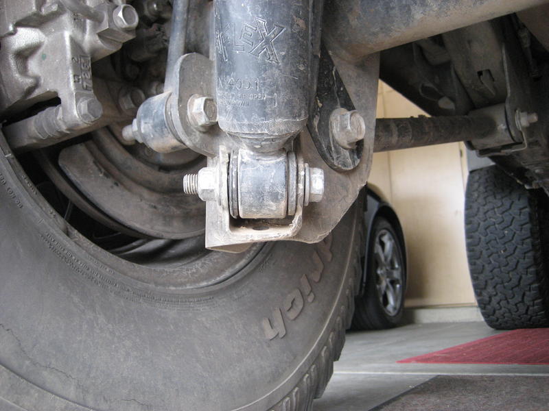

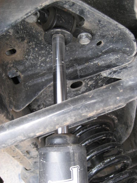

Did you inspect your shock housing for any wear from rubbing of any kind? I know because of my TB relo bracket, it comes awful close to my shock and I've wondered if it would touch if I'm fully flexed. Inspect that area for any possible contact. I would also check your shock mounts and see if there is anything unusual with them (bent or cracked).
Thanks for the replies. I'll take a closer look tomorrow when there's daylight. I know my rear end is centered. I've done the measurements after using an adjustable trackbar bracket. But yeah... this is weird. I know.
I'll definitely take a closer looks to see if anything is contacting my shocks. I'll also check to see if my axle shock mounts are bent or unlike the other in any way.
Keep the replies coming, please.

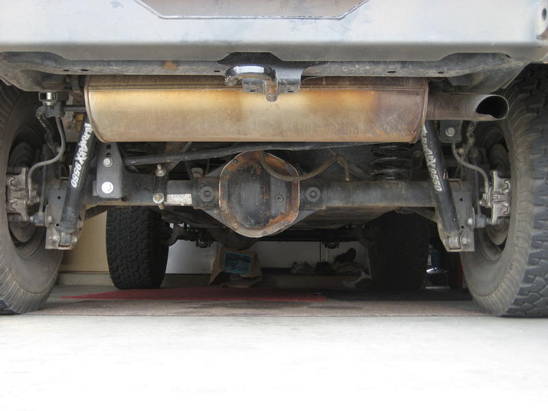

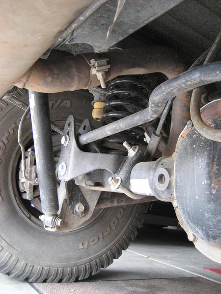

I netted about 4" of lift. After looking at the pictures myself, my rear coils are perched forward and my stock rear sway bar links are angled forward too. I know I need rear upper control arms because my driveshaft's angle is way too steep...
Could investing in rear upper control arms, in order to correct the angle of my rear driveshaft, have any effect on this "clicking" coming from what I believe to be one of my rear shocks?
Or would rear upper control arms have no play on this issue, considering this "clicking" and busted shock issue has happened with my 2" budget boost before this coil upgrade?
