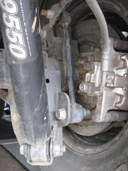

Pictures!!!
Jeep Rear End
Driver-Rear
Driver-Rear
Driver-Rear
Driver-Rear
Driver-Rear
Driver-Rear
Passenger-Rear
Passenger-Rear
Passenger-Rear
Passenger-Rear
Driver-Rear
Driver-Rear
Driver-Rear
Driver-Rear
Driver-Rear
Driver-Rear
Passenger-Rear
Passenger-Rear
Passenger-Rear
Passenger-Rear

Question???
I netted about 4" of lift. After looking at the pictures myself, my rear coils are perched forward and my stock rear sway bar links are angled forward too. I know I need rear upper control arms because my driveshaft's angle is way too steep...
Could investing in rear upper control arms, in order to correct the angle of my rear driveshaft, have any effect on this "clicking" coming from what I believe to be one of my rear shocks?
Or would rear upper control arms have no play on this issue, considering this "clicking" and busted shock issue has happened with my 2" budget boost before this coil upgrade?
