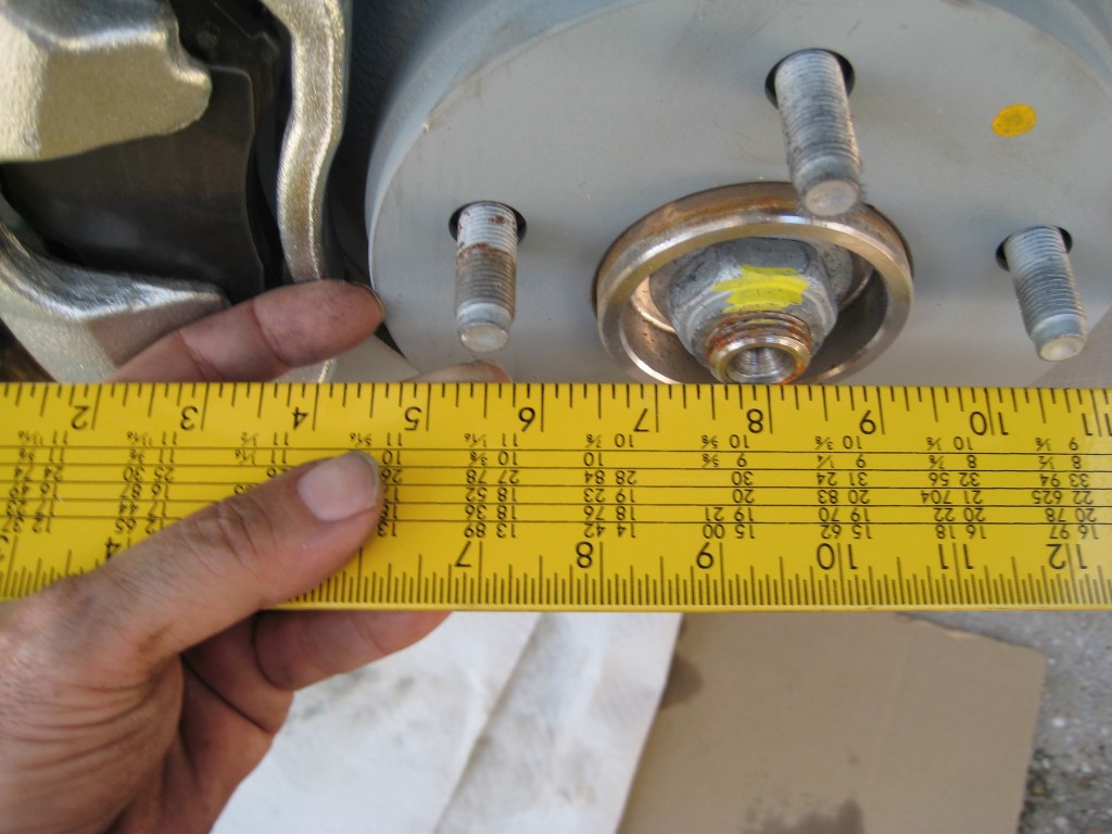

I have 17" rims but did measure my BBK for someone else with 16.5s and it looks like it may fit 16s but not sure. Worse comes to worst a little could be ground off the caliper if need be. These are the BR6 brakes with 13.25" rotors. With the framing square it looks like it would just fit but with the tape measure it looks like grinding would be required. Sorry, that's all I got. Otherwise I think you are limited to pads.
