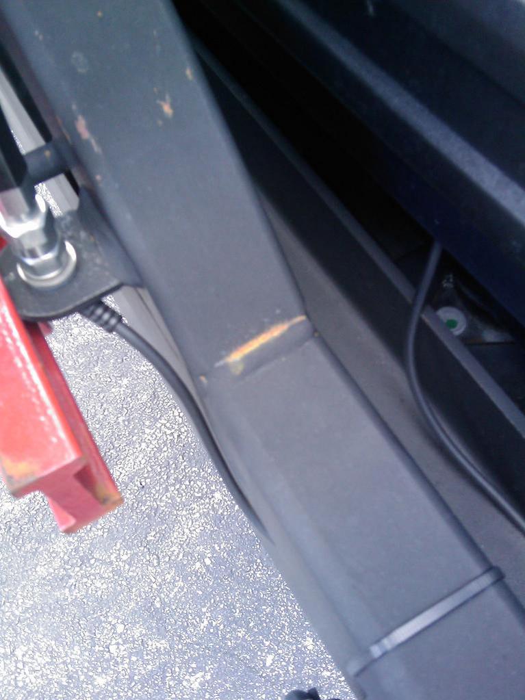

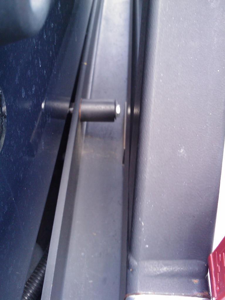

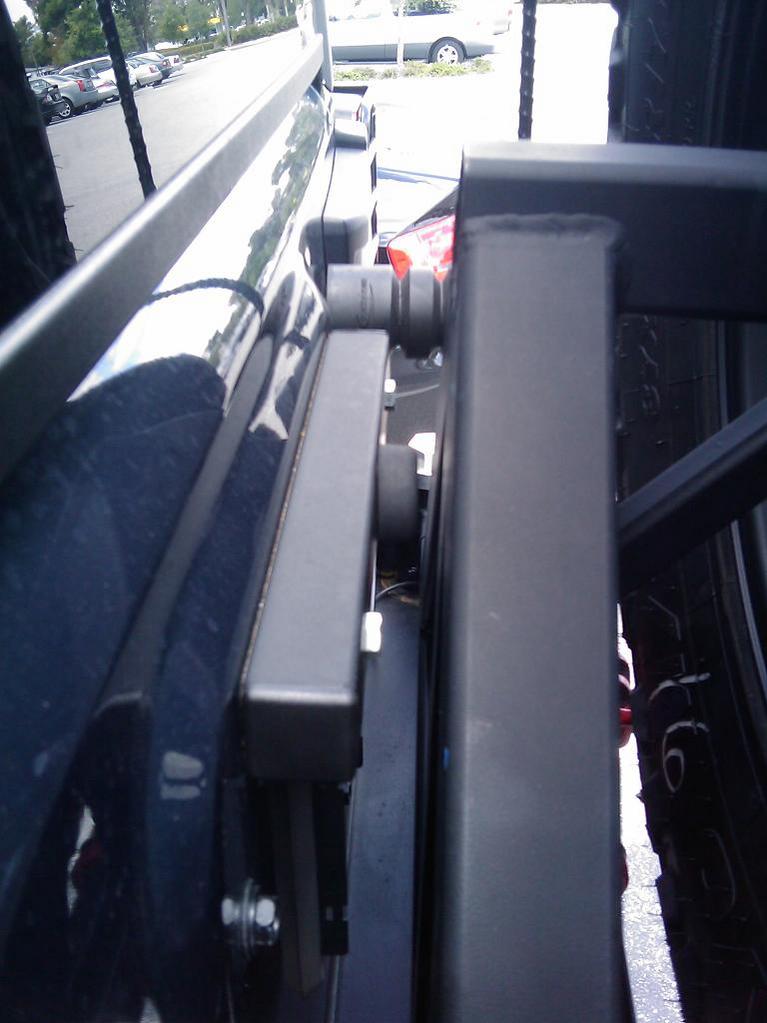

The problem is that I could not get mine to go back any further, as you can see, my rubber bumps aren't touching the swing out cus the bumper will not go back any further (the one near the latch has rotted off twice). I think most of the rattle comes from the peg that the latch hooks onto. If you swing in and out alot, eventually the peg loosens and that causes the rattle. If you're bumps aren't touching, then that causes even more stress on the peg, loosening it up sooner.
Also another reason I was unhappy with the bumper was that the powder coat started flaking off within the first week and showed signs of rust almost instantly. When I called RockHard about it, they said they had a few bumpers that were powdercoated by a company they no longer use, but that I was pretty much SOL.
I bought mine from Quadratec and they just referred me to RockHard, so pretty much I was dead-ended unfortunately.
