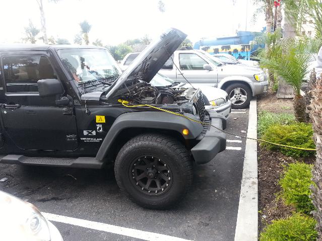

Ok jeepers..my friends been having a ton of issues with her 09 wrangler unlimited. When we turn the jeep off it continues to die. Its been looked at (dude might not have been that bright) bc he said the battery terminals were loose..so he "tightened" them and said its good..we keep having to jump it everytime we try to turn it back on..it just makes a clicking noise everytime like it wants to turn over..but wont. The battery is roughly 3 yrs old. Do you all think its the alternator??? Or just the battery flat out? The battery is obviously an easy fix but the last time it was looked at (about a month ago) the terminals were changed and we were told it was good. Which is why im leaning towards the alternator..help please guys

Yeah thats what ive been telling her but when shes taken it shes been told...well lets just say non helpful info...which is frustrating me bc this is SUCH an easy fix. Im just going to replace her battery and go from there im just worried about why it wont hold a charge..she doesn't take it offroad or anything whereas I take mine and abuse it haha. Anyway thanks for the reply! On to troubleshooting
