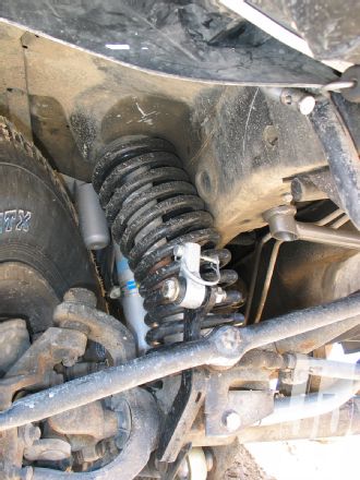

Spacers are not the answer to compressed coils from added weight. You need new coils designed to carry the added load.
How does a spacer fix this? Click image for larger version

Evening out front to rear and a .75" loss due to weight will not make a coil look like that....

No, that is an extreme example used to illustrate the point. Adding a spacer to a compressed coil still leaves you with the same compressed coil with the same associated lack of range/bottoming out, etc.
