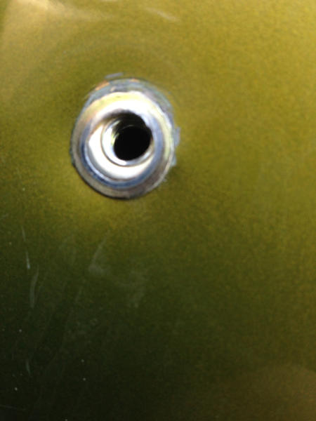

Looks like u went a lil too far. One of the nut serts for my trans cooler did that and I had to drill it out. Looks like it will be much more of a pita to drill out of the sheet metal:(

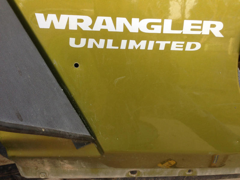

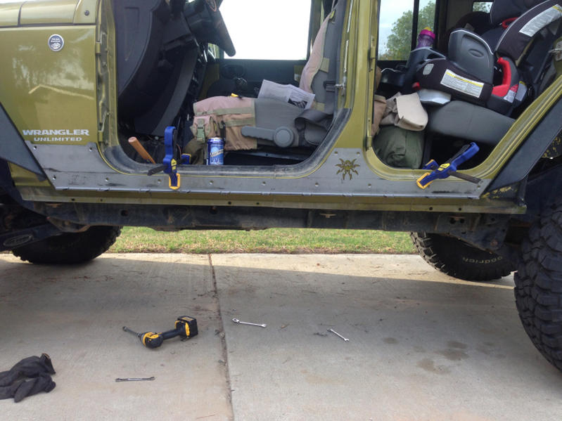

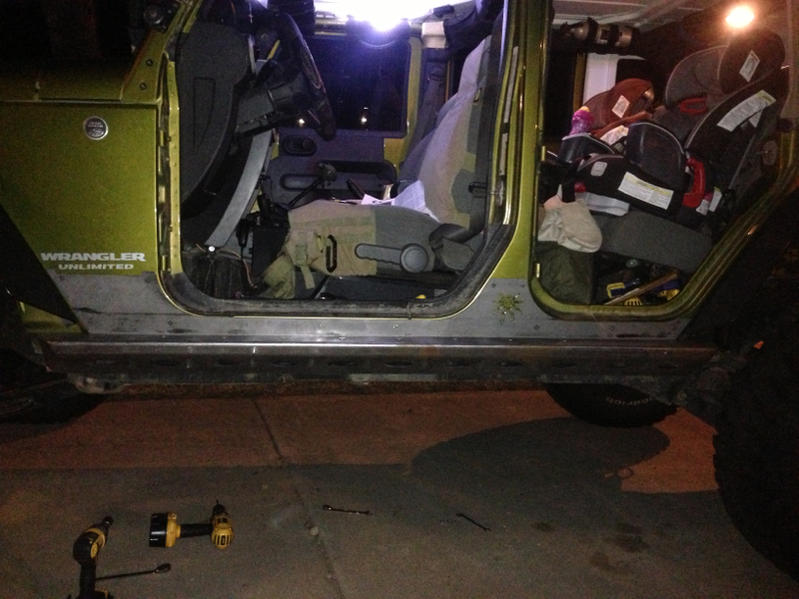

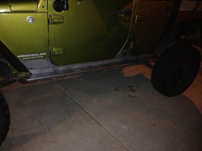

Well I went ahead and powered through it. 2 hours, 7 beers and a few "wtf" moments and I'm done side one.
Well I have to paint it still but at least it's mounted!

That's just a defective nut sert. One side collapsed before the rest. They are supposed to collapse on themselves evenly. Gently using a pry bar helps and you don't have to drill it out.

I think the problem was 1, I tightened to much. 2, the provided tool wobbles when tightening due to slope between the bolt and "tool" part. Either way, they all lines up and are holding strong. Rock!
