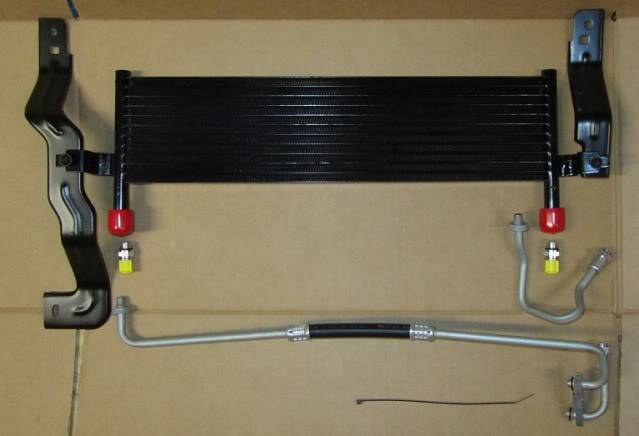

First things first :
I see where you have an automatic trans:
Do you have an aux cooler for it ?
https://www.jk-forum.com/forums/atta...8&d=1355425193
The Stock Cooler allows the trans to run hot (because of it's location ) in sand and on trails with bigger tires increases load to the trans ( no matter what gearing you have ) Mods are nice, but you have to approach your build with logic, it will save you money in the long run.
