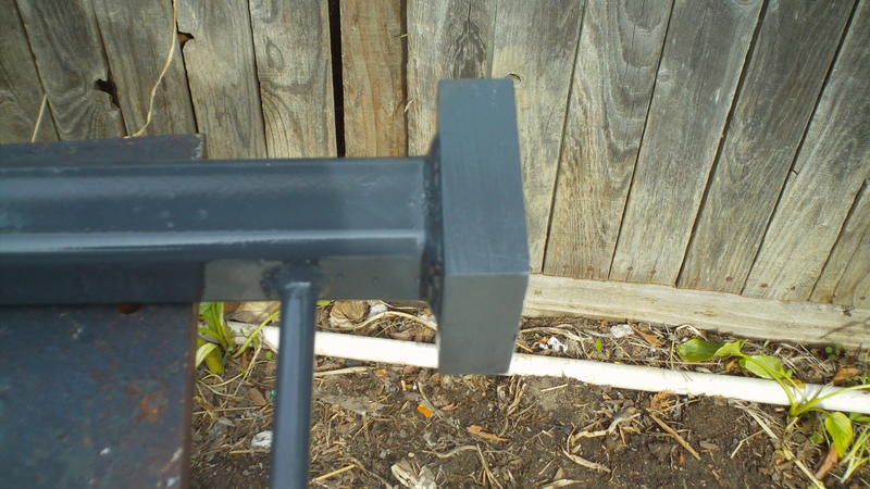

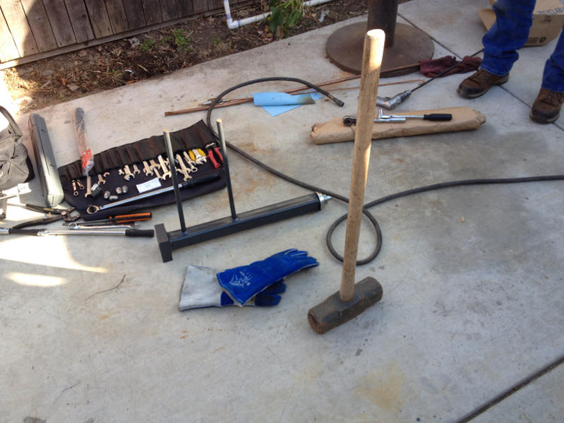

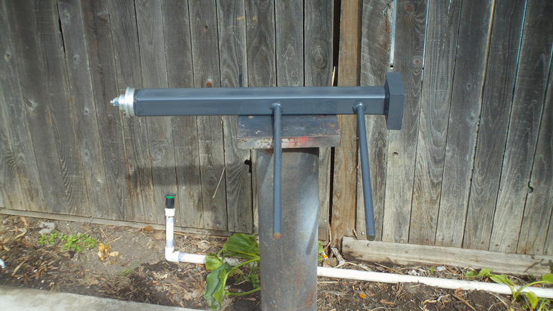

Originally Posted by smittycm
For those in San Diego area that have installed Nitro sleeves, did any of you create an install tool for the job that I can borrow? I seen a video online where it looks like they created an install tool out of some square tube and flat stock. I could get something similar created, but I figured I'd ask if anyone had a tool that they already built laying around. I'd pony up a case of beer if you let me borrow it.
Will this help.You can PM me for a detailed info
