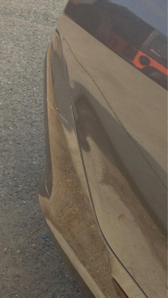

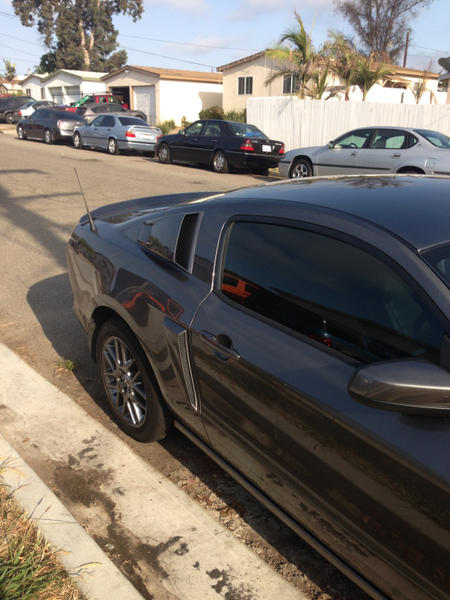

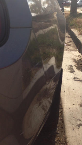

You can see the gouges in the plastic bumper and there are a couple dings in the rear quarter panel.

The dents are super small. They are just bugging the crap out of me knowing that they are there. I plan on having them replace the bumper since the paint and plastic are screwed up on that.

First Semper Fi! Second as for the repairs get an estimate for repairing and refinishing both panels which you will be entitled to. The insurance company will not replace the rear bumper unless a mounting tab has been torn and can't be repaired ( You do not want to replace it anyway as there are VIN stickers on all major panels and this would eliminate the rear bumper one) . The best repair would be to do paintless removal on the quarter panel and a spot repair with full clear coat on the rear bumper with it off the vehicle eliminating and chance of over spray. I was a body shop manager for over 20 years and an insurance adjuster for 5 as well. The insurance company is required to make you whole after the accident. They will cover repairs, lost days from work and a rental while the car is in the shop. If I can be of any further help feel free to contact me. Rick
