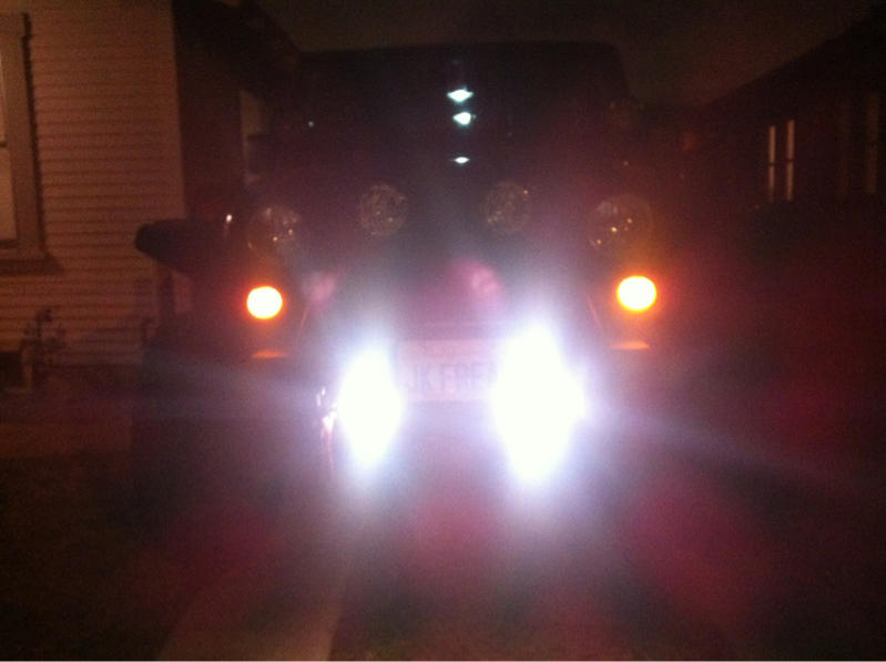

Had to replace my fogs after they blew... used Silverstars... I'm blind!

Hey mike how much lights it to much lights? Lol

Which silver stars did you go with? Was it a pita to do?

Yeah the Sylvania's are a good affordable bulb. I use the Silverstars in my fogs, Silverstar Ultras in the head lights. For sure brighter and whiter over stock.

They're number 9145 Silverstars. I don't think they make the ultras for fogs though (if they're too bright it kind of defeats the purpose of fogs I think). I have the "regular" Silverstars in my headlights as well.
They're incredible easy to change out, depending on your front bumper. I have the RR XHD stubby. Just turn the bottom of the mount post (at the light harness) a quarter turn(counter clockwise I believe), pull it out, disconnect the old bulb from the factory wire harness, pop in the new bulb, then push in and quarter turn the other way to mount.
