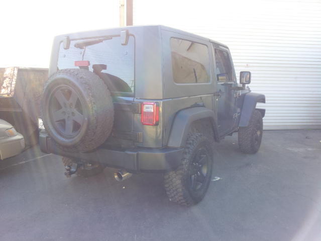

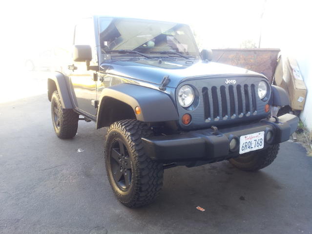

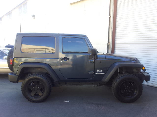

2.5" teraflex spacer lift with shocks

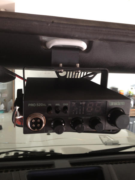

Strike force zebra mount

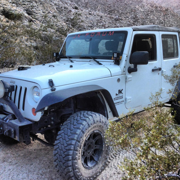

Threw on a bds 3" kit before the desert run. Thinking metal cloak coils and a decent shock setup in the near future. Maybe some air bumps for the desert

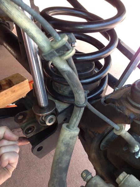

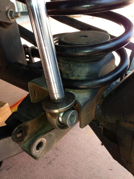

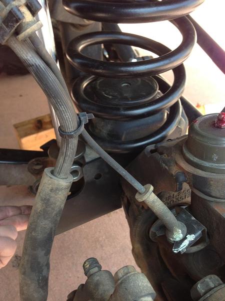

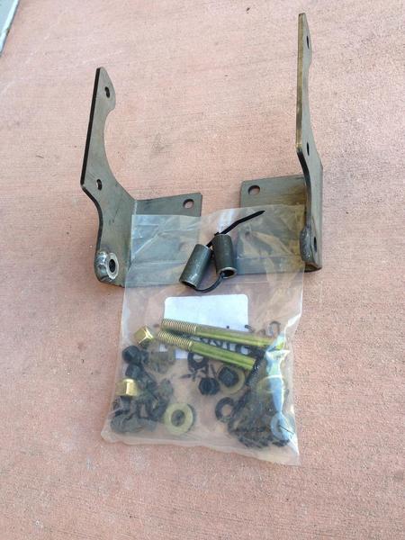

Got to 60,000 mile front and rear diff oil changed today.
Tried and true the Rebel front lower shock bracket. Need to mill out the bracket to fit over the EVO C's
and weld them in or just cut off the section of the bracket that goes over the axle tube completely. The
latter I would bolt in 3 locations. Not to keen on weld on weld of the C gussets, what would be your call?
