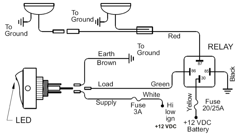

Sweet night run! They have one next month! Hopefully I can install a relay before
We can wire one up pretty quickly at the SnG on Thursday if you want. What's the problem with your light setup?
Really? That would be awesome. It that when we first installed them we didn't know we needed a relay so we just hooked them up to the battery and we put a in line fuse.
So now you have it going from battery to fuse to cab switch to lights? This might require more wiring than simply adding a relay to get your setup correct, but I'll bring one with wires labeled so you can add it on and show you what you need to do.
I just looked at it my dads friend put the two power wires from the lights to the switch and the ground to the battery then from the switch he ran a wire to the battery and installed the inline fuse in that wire. Okay thanks Mike.
Yeah let's mess with it Thursday. Here's a diagram how it should be wired using a relay.
Or.... get an sPod and call it a day!
<img src="https://www.jk-forum.com/forums/attachment.php?attachmentid=471300"/>
I would if it was in my budget lol! Okay thanks mike yeah I'll show you Thursday

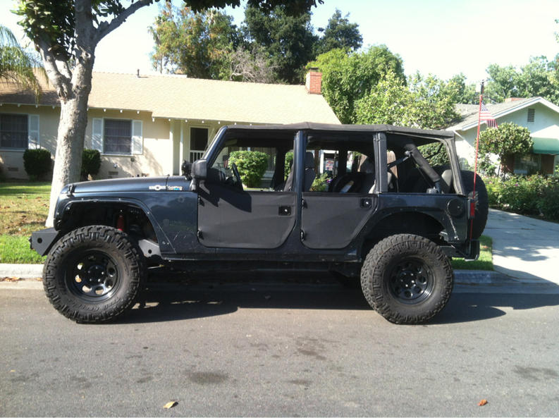

Yyyyeeeaaaaa buddy.. Soft doors came in today.

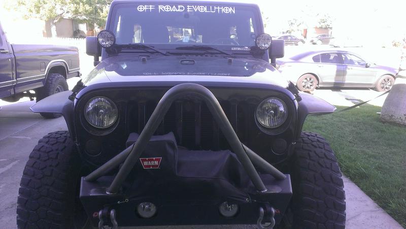

Made my own stinger, welded it on Saturday morning, tomorrow I will weld the 2 gussets
<img src="https://www.jk-forum.com/forums/attachment.php?attachmentid=471540"/>
Looks awesome

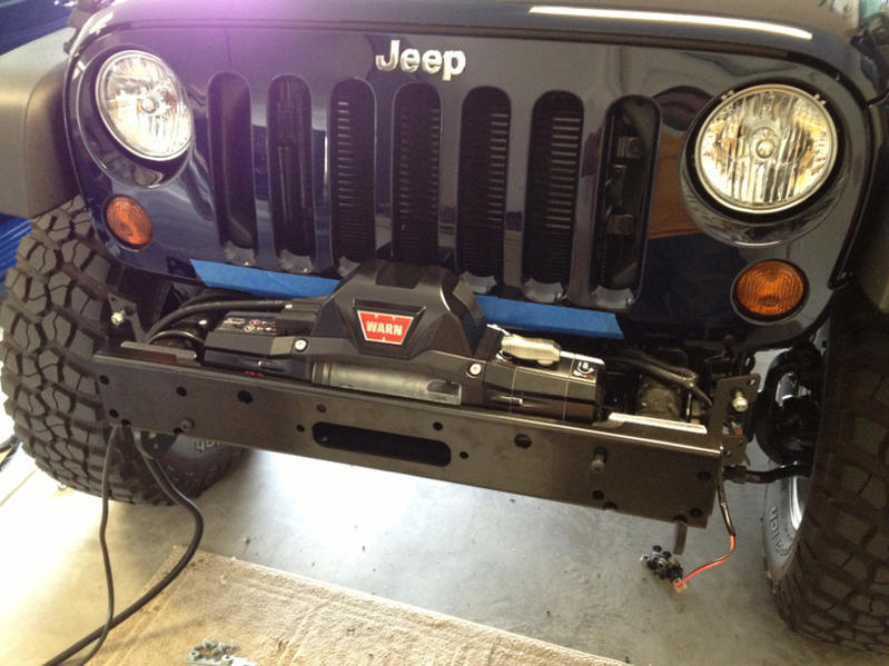

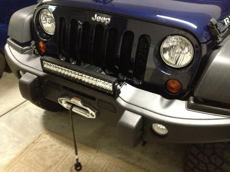

Winch installed&hellip; Warn Zeon 10-s
ID:	471691   Click image for larger version
