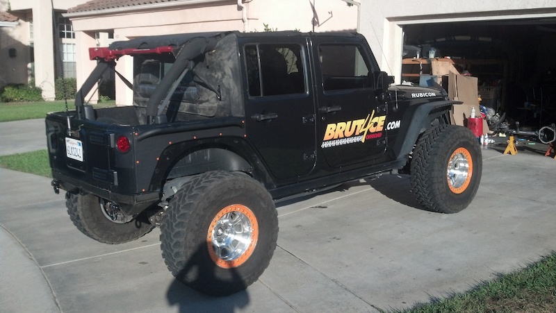

Did soft top surrounds , hooked in safari top and wind jammer. Getting ready to make a tire carrier in rear cargo that's hingeable-

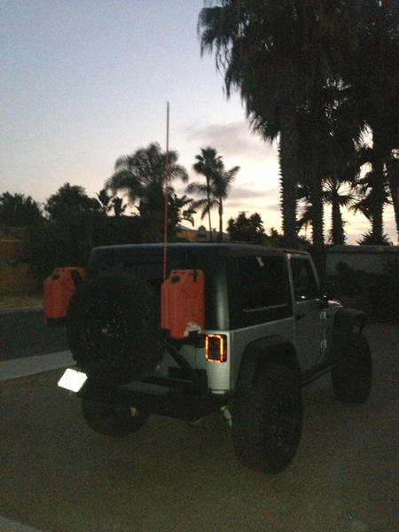

The mod that most start off with took me a year to do hahaha. The CB radio

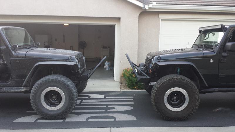

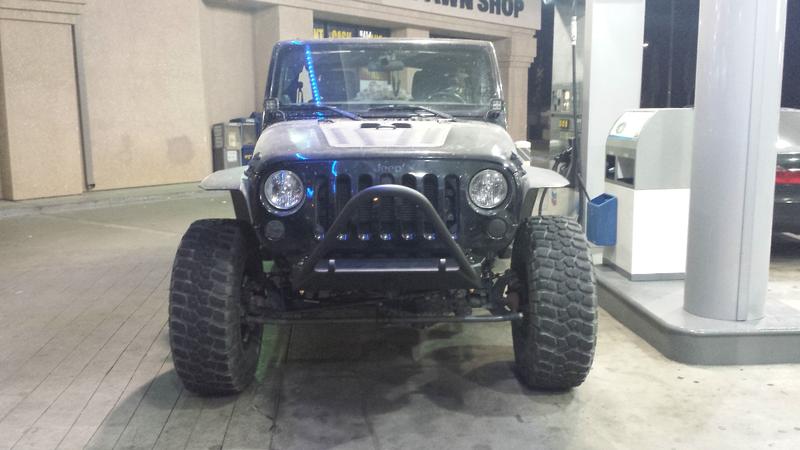

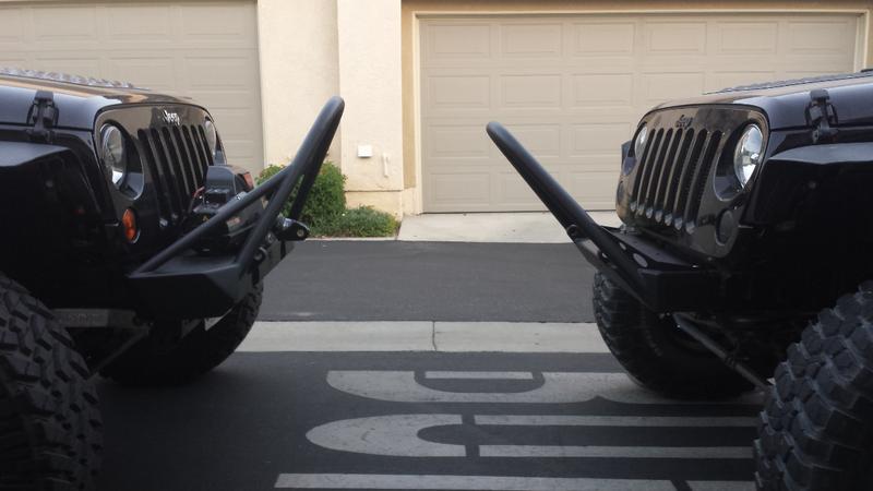

Just installed the POISONSPYDER BFH front bumper yesterday

Wicked! Was chopping the frame difficult? I'm torn between this and the Brawler lite.

Looks good. You selling the quarter armor?

Chopping it was pretty easy. First I cut 2" of the frame rail ends off. Then I cut the brackets that connect the crash bar to the frame rails, I used a sawzall for this. Then grind all the welds down and.then sand them smooth, prime and paint. Then u slip on the bumper, drill the 1/2" holes, put in 4 bolts and torque to 85 ft./lbs. DONE! Probably a couple hour job total.
The brawler probably only takes 5 mins to install

Yeah I'll make em if someone wants em...I've tried and tested mine on the last 4dr I had and love em...ta,e a serious beating....

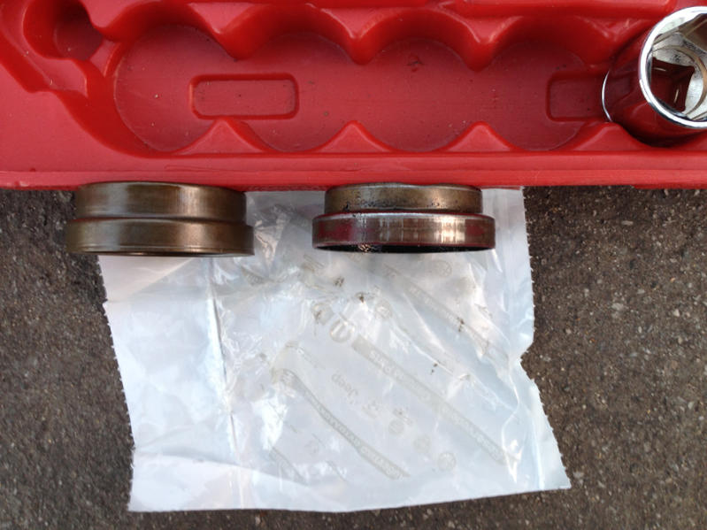

Replaced leaky driver side axle seal (and passenger just for the heck of it). Took a LONG time..... And now my front Rubi locker isn't working... FML
Check out the Yukon seal (right) I pulled out vs the Mopar one (left). The Mopar one is way thicker, weird...
