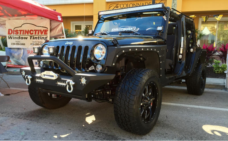

Installed the Smittybilt XRC Armor fenders. Holy pain in the ass to put on. But it turned out great.

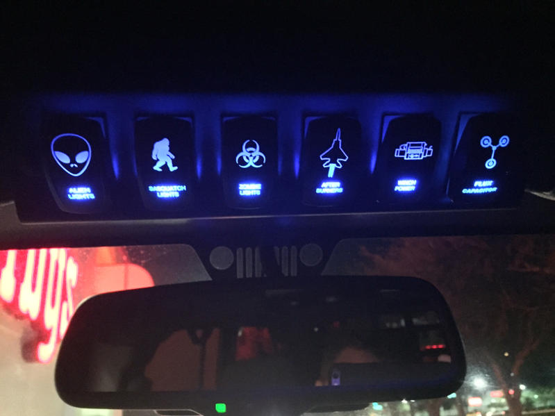

Installed switches for all my lights. So freaking cool!!!

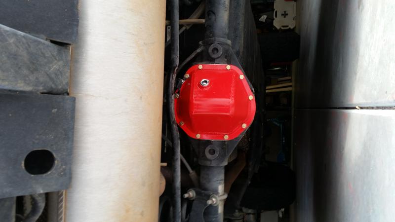

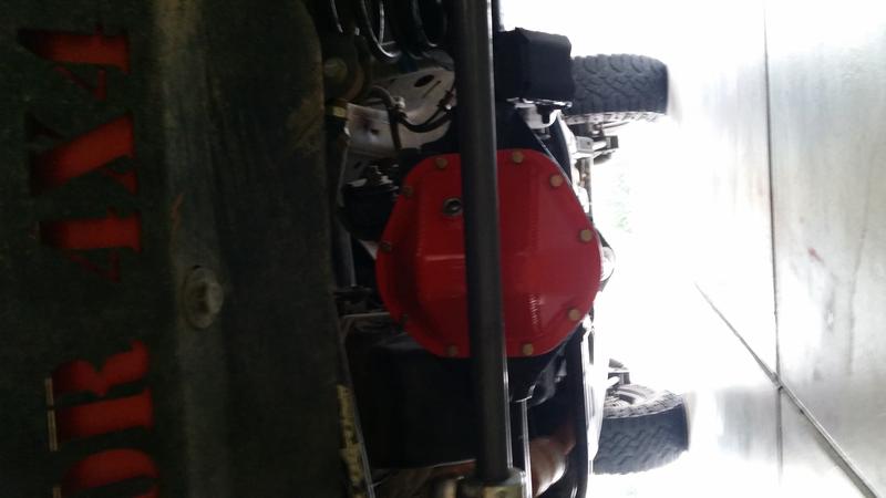

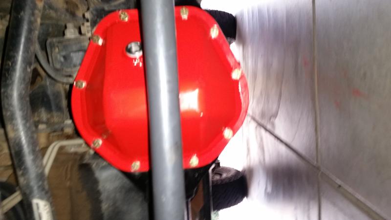

Synergy Ball Joints, C-Gusset and sleeved, Ruffstuff diff. covers

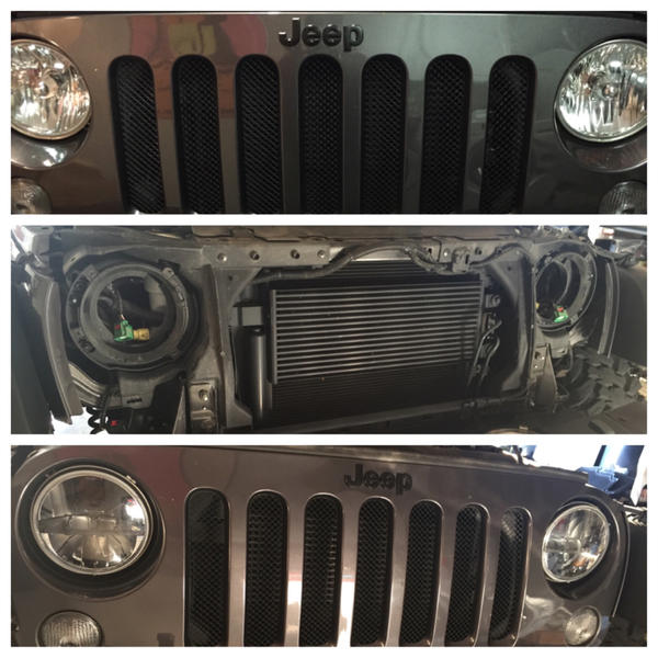

Just installed the trucklites... Took 10 minutes! Now it just needs to get dark.

best mod I have done yet. Love them

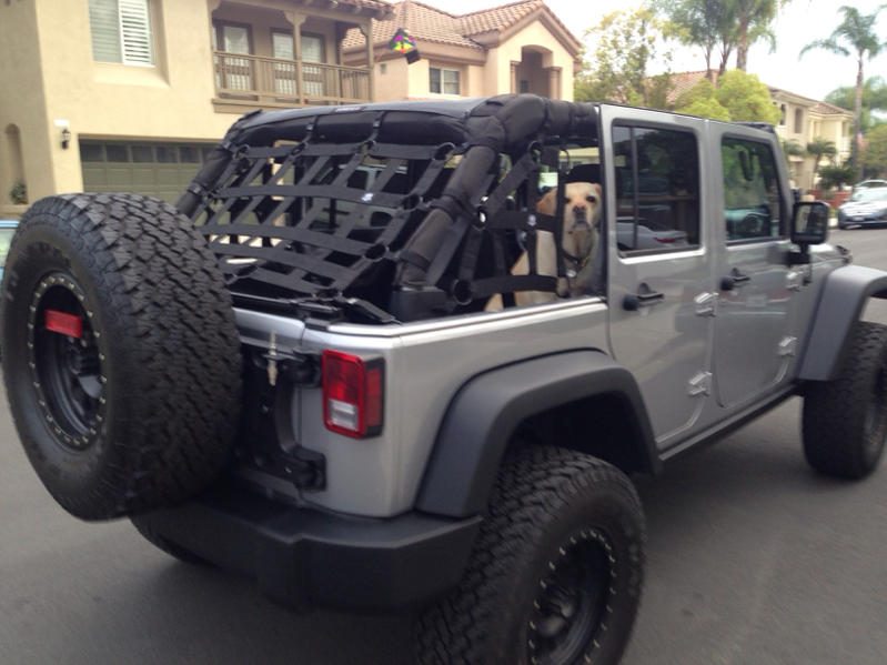

Time to go topless. Added safari straps. Very good quality craftsmanship

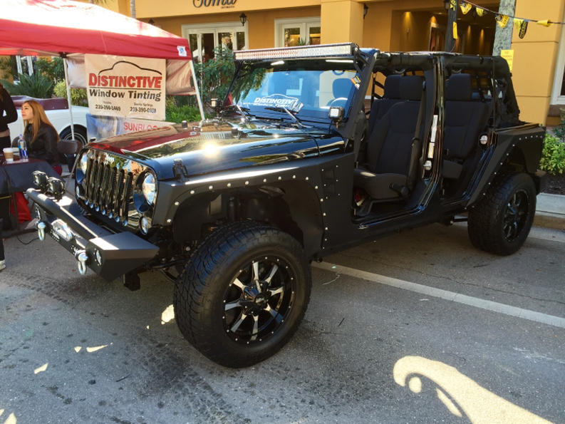

Rigid D2's, ebay 50 inch lightbar, S-Pod and OTRATTW Switches

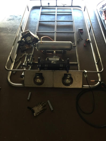

In the process of making a roof rack for EJS. I bent some 1.75" .120 wall tube for the base tube, 1" .090 wall for the top hoop and sides, and 1" square for the bottom. I added a air compressor with a 2 gallon tank and another 2.5 gallon tank plumbed into the airtight rack. That should be enough air to power the train horn and help with the tire inflation.
