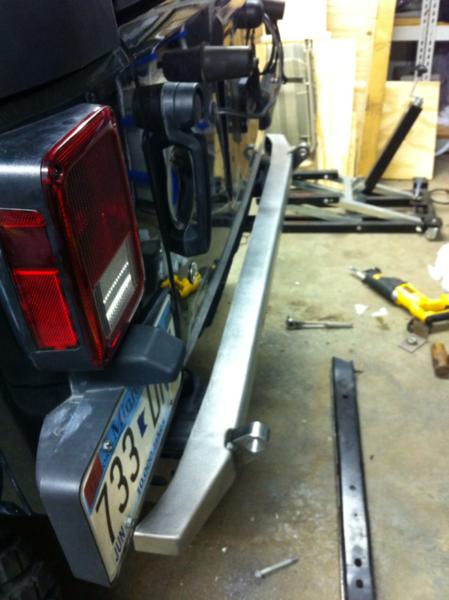

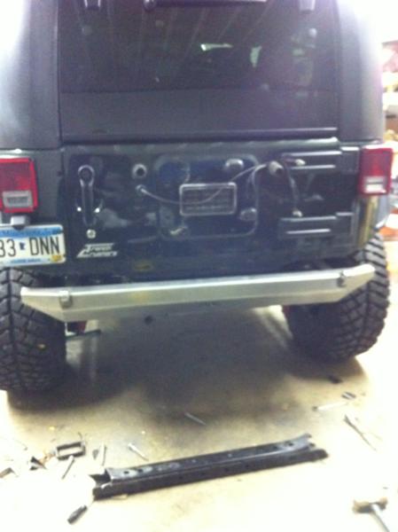

New rear BFH bumper
Headed to powder coating in the AM

Originally Posted by matzjeep
I thought the instructions said to trim the lower portion off of the rear crossmember? Did you just cut the whole thing off?
Yup, I'm adding a crossmember with a receiver hitch integrated. Then I'm going to notch open the bottom of the rear bumper where the fancy dancy poison spyder is stamped to run my receiver hitch

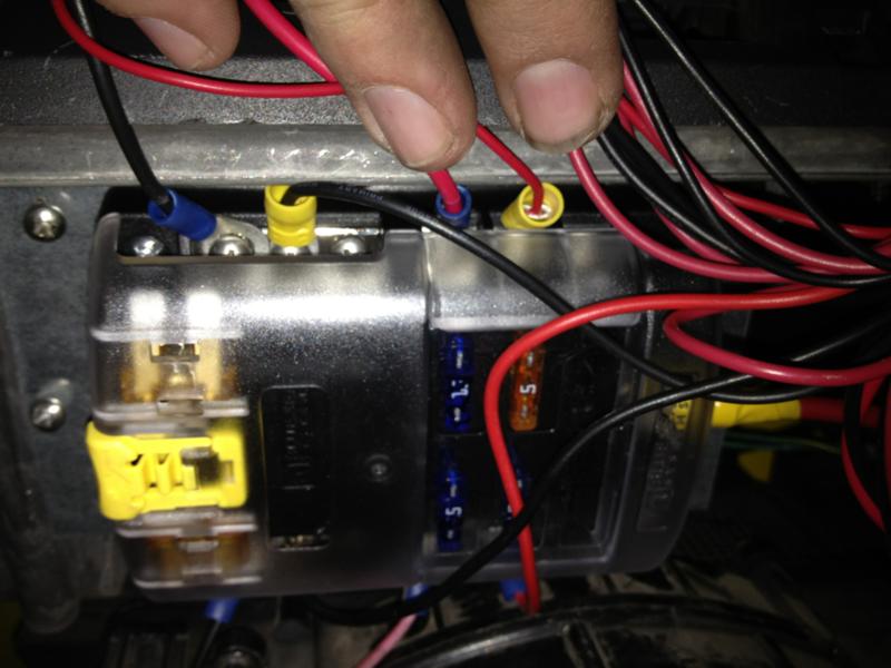

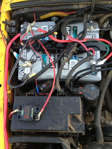

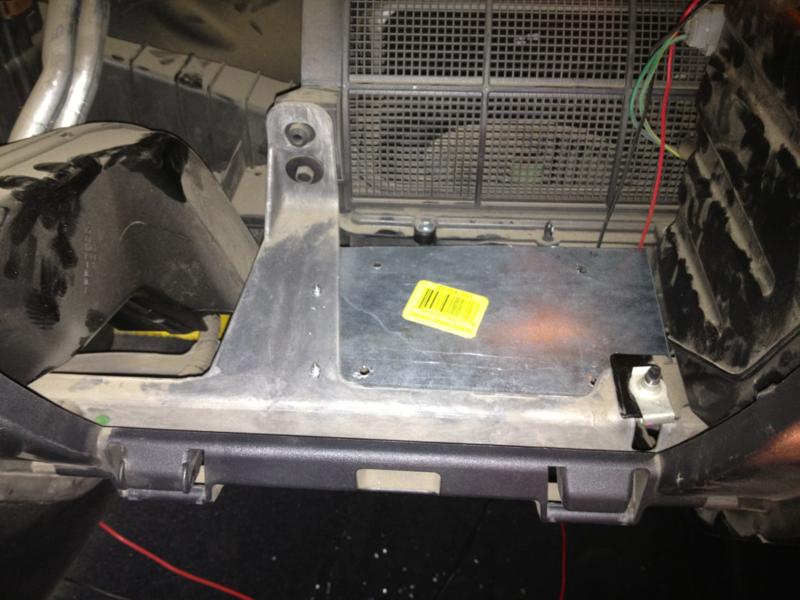

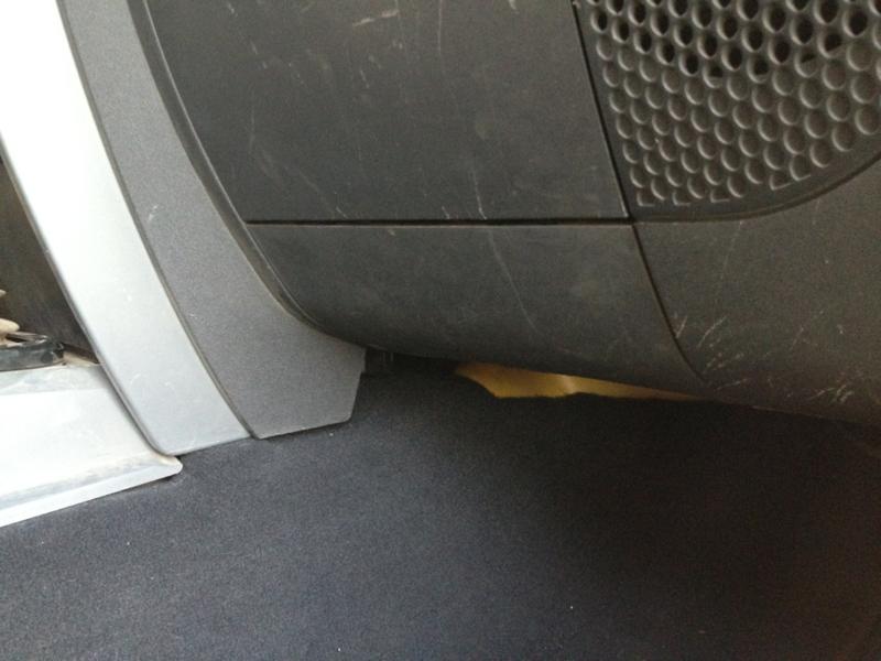

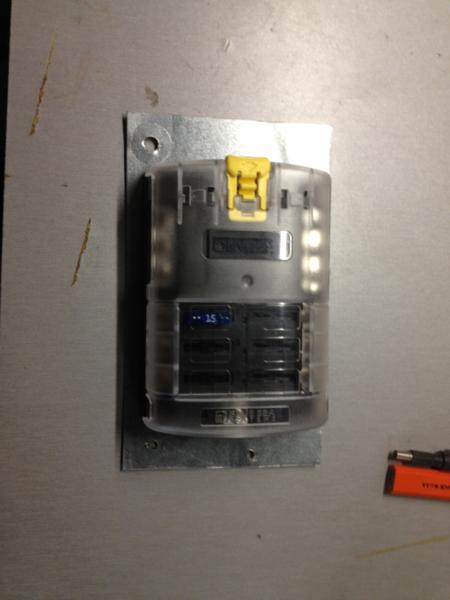

Rewired my LoD rear lights, rock lights, 12v outlet and cb. Connected everything to a fuse block which is connected to a circuit breaker before going to the battery. I placed the fuse block underneath the glovebox and the circuit breaker on top of the main fuse box. Here are some pictures.

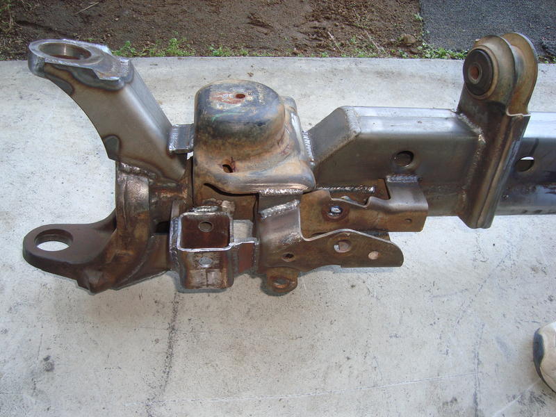

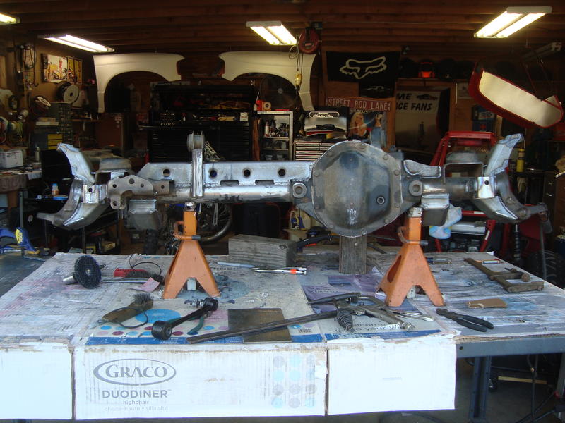

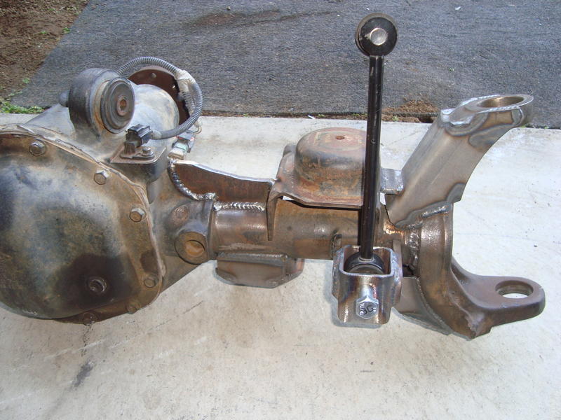

Cool Truss central ;-)
Hey Nick,
Finally moving forward on the Dana 44
Next is ball joints and then gears
