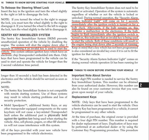

Did you have the unlabeled red light by the fuel gauge on? That will absolutely, 100 percent, tell you what the problem is if it's on. No need to look elsewhere. Your symptoms sound exactly like the antitheft system has engaged. The light is unlabeled, but it is exactly as I've described. If it's not staying on, then look elsewhere, but if it's on, no need to test the battery, fuel flow, or engine codes. Your Jeep thinks it's being stolen, and will let you start it, then die in two or three seconds. Sound familiar?

Here, more info on that light ...
Again, the light is not labeled. It's adjacent to your fuel gauge. Look for it during bulb check--you probably never even noticed it before since there's no label on it. In my experience, you don't have to disconnect the battery POSITIVE cable for very long to reset. I did it for about ten seconds. During that time I did touch the POSITIVE cable to ground to ensure all stray voltage was discharged. As I wrote above, happened twice to me. So if this is what's happening to you, you probably don't want to be in the situation where you think you have to leave your Jeep at the office overnight in order to reset the antitheft system.
