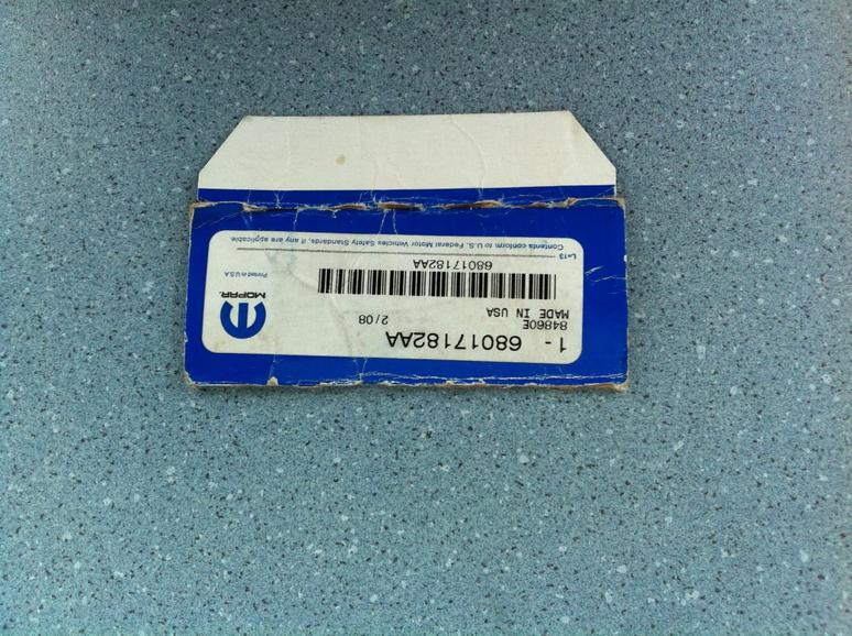

I bought on EBAY to Mopar 68017182AA steam.
$ USD 198.5 together with delivery to Kazakhsta.
Everything works.
