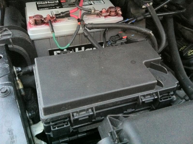

I wasn't riding the Jeep quit on me lol. Heres a pic of the TIPM

can i put the TIPM (total integrated power management). in by myself.and where can i get one at a good price the dealer want to much for it talking about 420 for it.only the part..
Old Jul 4, 2011 | 02:03 PM
BHawks4Life's Avatar
Posts: 263
From: Illinois/Wisconsin
Way too much, moparpartsonline.com or I even saw one on eBay that was being sold by a dealer. Just make sure it new. Maybe try a different dealer or try working with them on the price. I always ask for a better price from the dealer and usually get something off.
