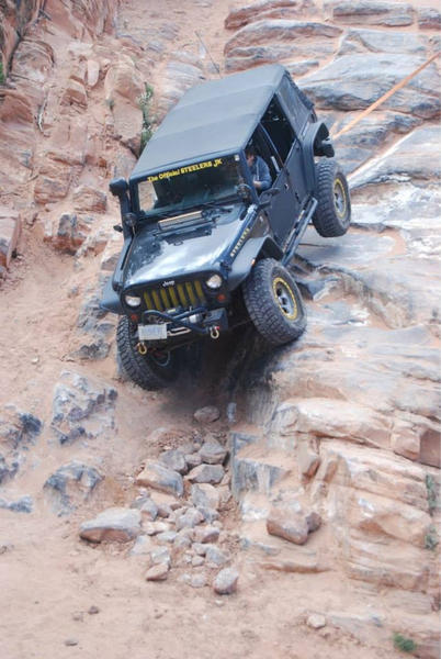

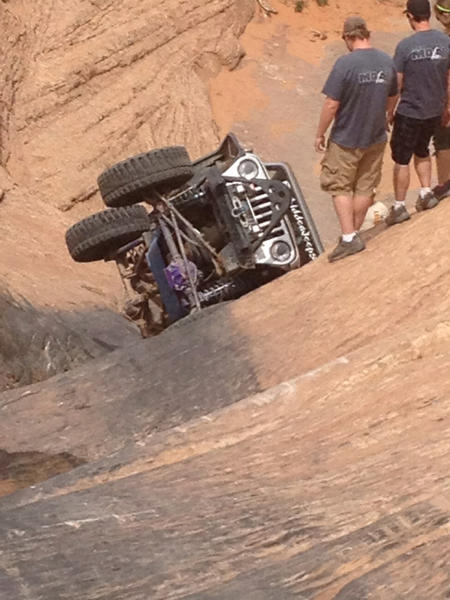

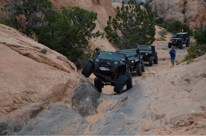

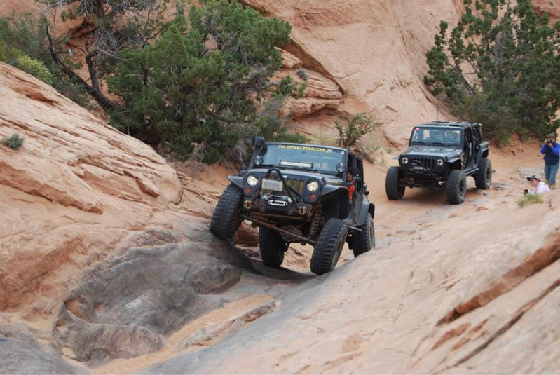

Old May 22, 2014 | 02:11 PM
robsjeep9's Avatar
Posts: 3,802
From: Kitchener
Originally Posted by OH9JK
I have a 2 dr and wouldn't have it any other way. The 4 dr guys I wheel with go everywhere I do but they tend to get high centered more often and have to do a lot of 3 point turns on the tight trails.
Steep inclines or declines the 4 dr have the advantage over the 2 dr hands down. The longer wheelbase definitely feels more stable and if you want to run really large tires I would choose a 4 dr over a 2 dr.
I agree .... After doing Moab I'll stay with my 4 door 37's and 4" lift .... the 2 door in our group was scary to watch at times lol
But really depends on what type of trails you're into.
