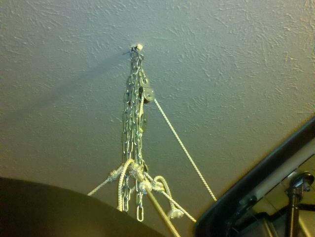

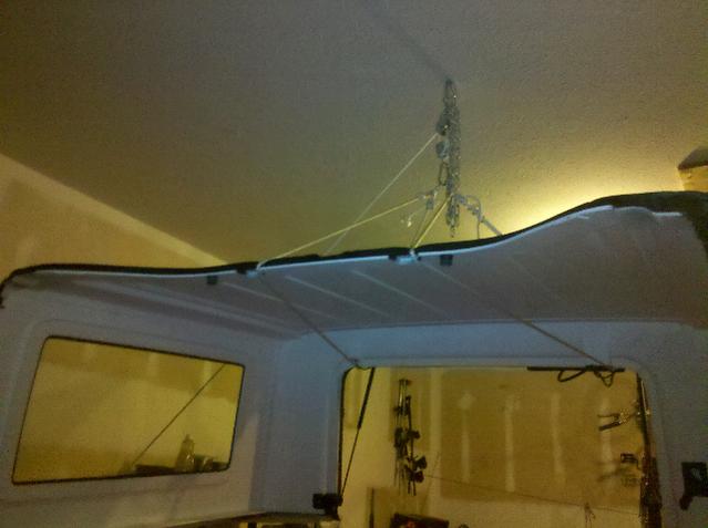

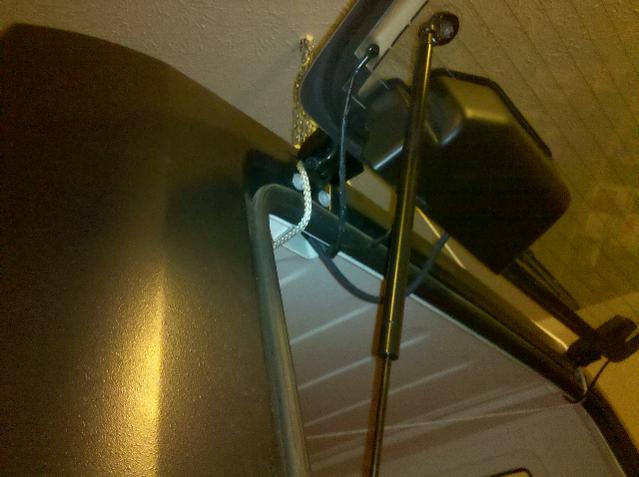

I put a 4x4x8 post in the attic and looped a chain around it. Then attached 2 pulleys at the top and one at the hard top so the rope doubles back on itself, halving the effort required to lift it. I used ropes that together rated for what I think the hard top weighs. The loops at the ends of the ropes are hooked onto single chain links that unscrew when you need to put the top on. You should be able to see where the ropes go from the pictures. So far its worked pretty well. Takes maybe 15 minutes to get the top off. Most of that is lining the Jeep up under the hoist and getting the ropes under the top.
