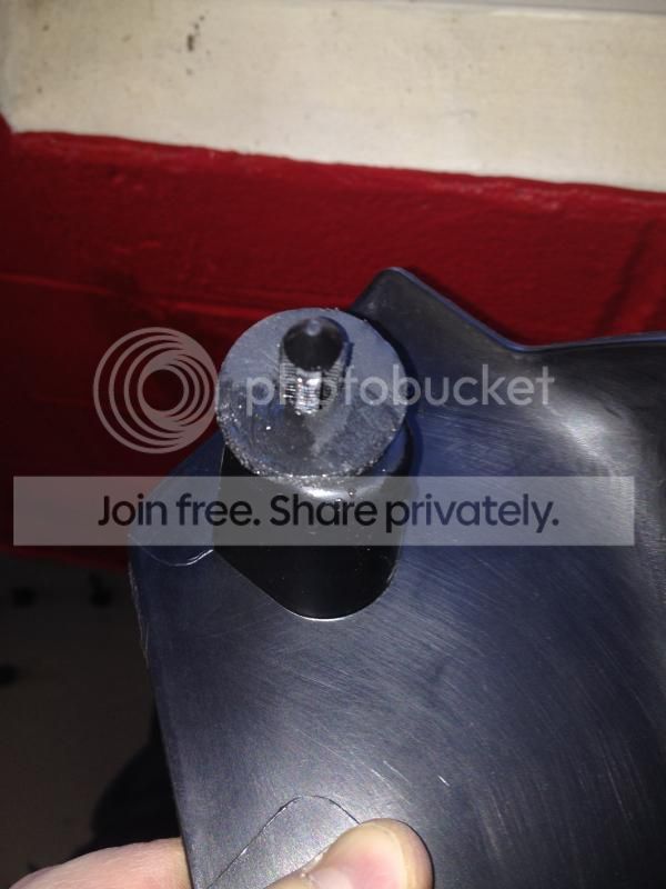

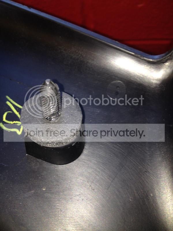

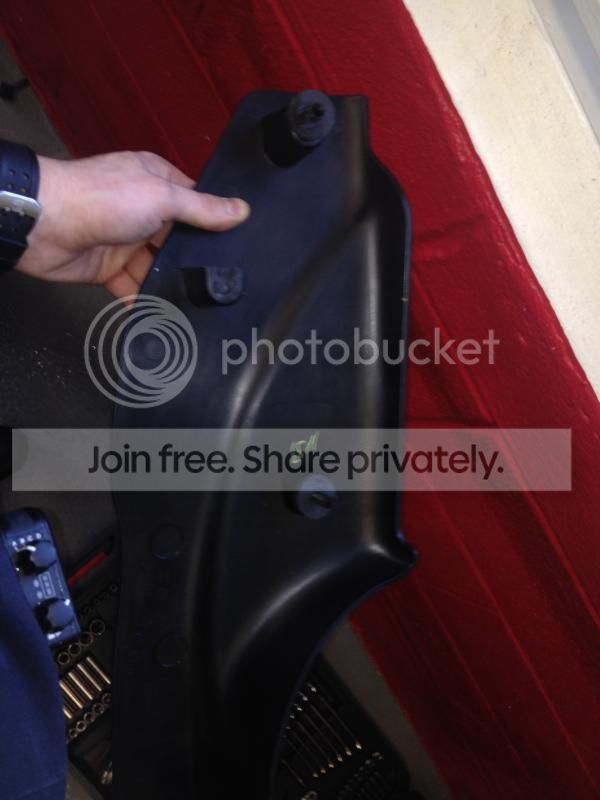

when you remove the the drivers side floor trim there are 2 plastic clips that hold the trim in place that have foam gaskets behind them. these:
located here:
you can see how the gasket is wet eh?

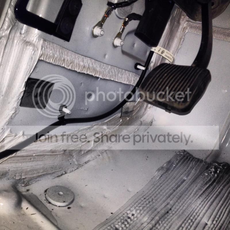

well they attach to these holes (covered by the silver tape):
after dis-assembly and leak-down testing (spraying with a hose) the exterior and seals i found water to be coming in these holes. which is why they had gaskets on them i guess :/ quick question: so they knew water would get in these holes so instead of coming up with a better securement solution they just said "eh, whatever." and put gaskets that dont work. Ok, fine. someones being lazy. so some strong waterproof tape and im gold. the trim holds in place just fine; not loose at all.

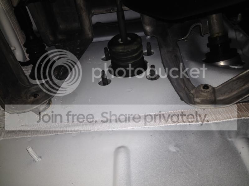

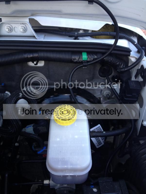

the bracket that holds the master cylinder to the fire wall is mounted with 4 bolts (non of which are accessible from the interior of the jeep and only 2 are easily accessible from the engine compartment without all manor of extentions, and angle devices). behind the master cylinder there is a gasket, which can juuuust be seen here:
interior view:
the bold at the 9 o'clock position leaks like a faucet, as does the one above it ( that is not visible from the interior but is visible from the engine compartment at the 3 o'clock).
the reason for this is the gasket that is behind the master cylinder stops before the bolts and they are not encircled. this is, again, incomprehensibly lazy on the part of chrysler. or fiat. or who ever.
solution:
silicon sealant.
all 4 bolts where loosened as much as possible without removing reservoir or brake lines or computer or any of the crap thats in the way. the brake peddle is depressed by assistant and sealant is pushed into gap between firewall and bracket at all 4 bolts (from the engine bay). then sealant is pushed into/ around bracket in the foot well as best as possible, tight space. (if you have small, girlish infant hands this will be easy for you. if not; well have fun).
the bolt were then tightened.
as of today, no leaks. left the carpet out to be sure.

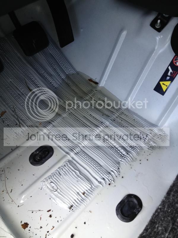

ALSO, look back at the picture of the footwell where the silver tape is: see that sealant job along the kick panel/floor board? who ever did that should be ashamed and the inspectors/supervisors that ok'ed that to leave the factory should be drug into the street and beaten with sticks.

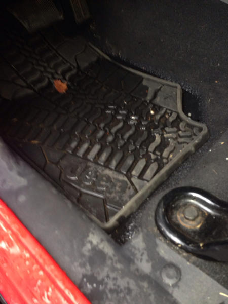

Well. Update to the leaks. Yesterday in Delaware it rained pretty hard. Guess what!? Give up? Yep. Drivers side carpet drenched under my bone dry liner. My dad bought last Friday and 2014 4 door Sahara. I felt the carpet (raining during his purchase) and it was very damp.
