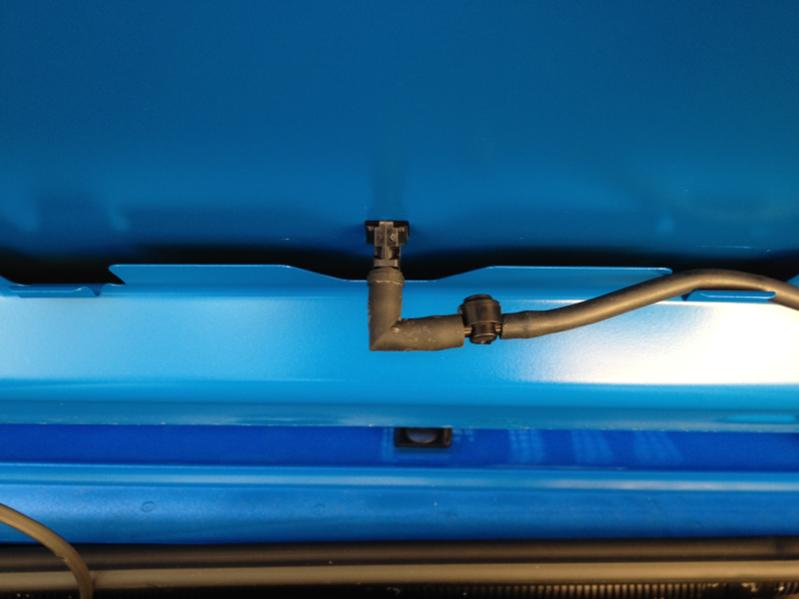

So another member found the windshield washer device was making contact and noise. By rotating the part 180 degrees this fixed it. But my noise came back.
This time I remounted the tube from the device to the sprayer having the short end of the 90 going to the nozzle and the long portion going to the device.
This gave more clearance and that noise is gone. Now trying to hunt one more center dash noise
