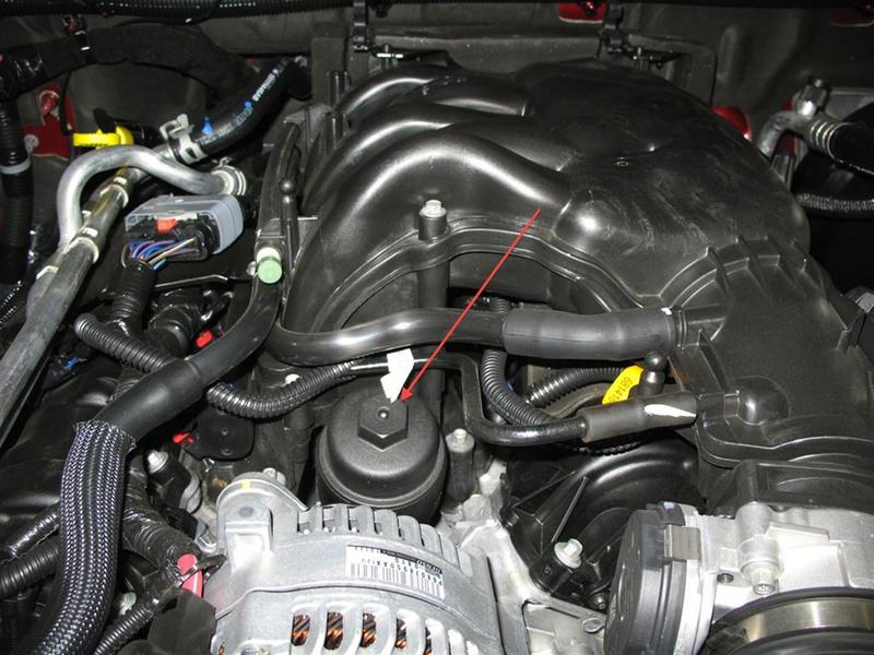

Now I need to figure out where this thing goes. With normal looking filters the thing stuck out like a sore thumb. What's the easiest way of accessing it?

I believe 15/16 and its right below the fancy engine cover on front of the top of the motor bro. Engine cover pops on and off.
Thanks I've been under there a few times and never noticed it. I'll pop it off to,or row after my Dyno run.

Filter location under the engine cover:
Name:	PentastarOilChange_0731 (Large).jpg
Old Aug 24, 2012 | 09:58 PM
powrsurg's Avatar
Posts: 988
From: Middle Island, NY
THats awesome! It couldnt get any easier.
