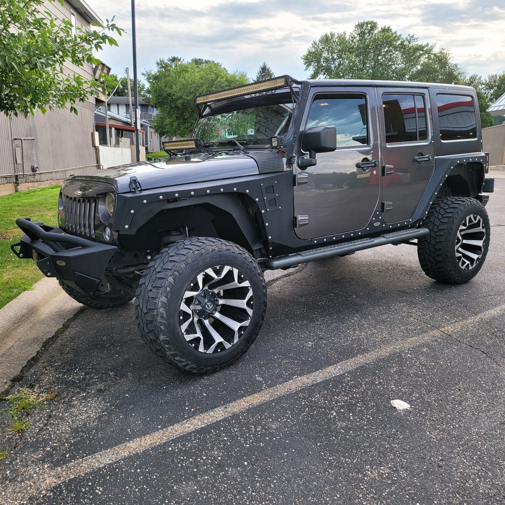

Thanks all - I may have bigger issues now. Got pulled over last night for the wheels extending beyond the fender flares last night as well as the uncovered light bars. They are steel aftermarket ones that are fairly skinny + wide wheels which came with the vehicle (we just bought it like 2 weeks ago). Now we are talking with dealer about selling us an illegal vehicle. It was already going back to the dealer to have them address the leaking shock issue and the electrical bug. And now this. At least the sheriff was cool and I didn't get a ticket or anything.
