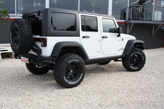

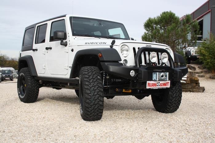

Click my link below to see my 285/70LT17 mud tires with no lift and no rubbing. Just remember that whatever wheel you use it should have less than the factory 45mms of backspacing. My wheels have 25mm for your reference.
