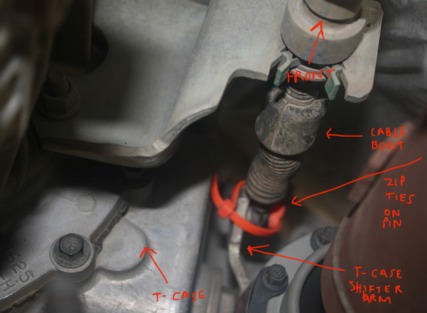

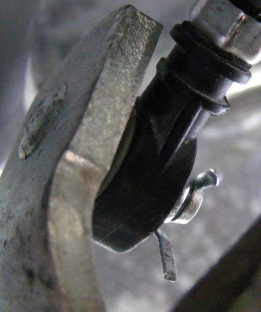

Pic of a zip tie fix and cotter key fix

So far the cotter key is working flawless. After about 100 shifts I've checked on it, not a budge on the setup

man what a pain in the but to get to.... I just got a zip aroung it till I can get it up on jacks to try to get a pin through it before Moab in Nov.
