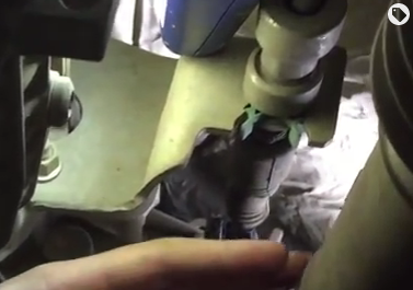

I think I have isolated the issue. The bushings are all intact.

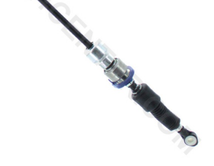

First thing I noticed was the clip Click image for larger version
ID:	672325 That attaches to the cable had come askew. It was still attached but slightly ****ed. I looked up a video on youtube and found this clip. Click image for larger version
Name:	Transfer case standoff.png
ID:	672327 I do not have that stand off mounted on my transfer case. I have a 2013 JKU, Did they delete this option? Surely it didnt just fall the **** off.
Any ideas? Should I buy the new cable or does my jeep need the standoff?

That's odd, I've not seen a reason to remove the standoff. The new cable won't come with one. You may be able to buy one off of a used transfer case if you can persuade a seller to get one to you. The clip is available through the dealer and they're pretty cheap as well as on hand.
Yeah, Its missing completely. The weird thing is, the bottom nut is on and secured...with wrench marks all over it, and the top nut is completely missing and the stud is bare. WTF. I think someone might have needed a $20 standoff more than me. People suck.

That's the cable housing anchor I was referring to.

Ok cool. Since mine was not installed I did not know what to look for. Got one on order from the dealership. I am sure this will fix my issue.
