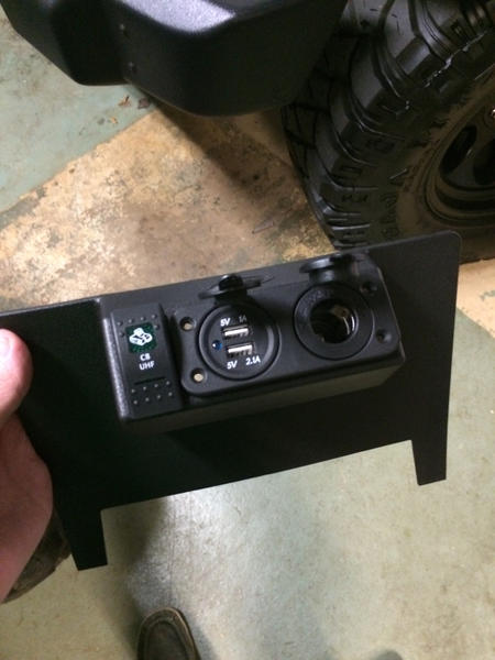

Im working on the same project. Ill post up when complete. 12v socket on constant, USB on 12v switched. Daystar lower panel to hold it all. Looks factory. Ill post a finished pic when completed.
That looks good. I was thinking about the same thing but in the power window switch cubby (since I don't have power windows). I like the daystar panel. Looking forward to the final install pics.

Using the quadratec tap from the switched 12v cigar lighter for the usb. Straight from battery with proper fuse / wire size for the constant 12v socket. While installing cupholder leds over the weekend I looked at tapping or relocating the center console 12v constant plug. I decided against it because taking apart the rear portion of the center console was a bastard. Im waiting on one small piece to come in the mail before I get to actually do the project. For now just gathering parts and scheming. ...sidenote the leds look great...
