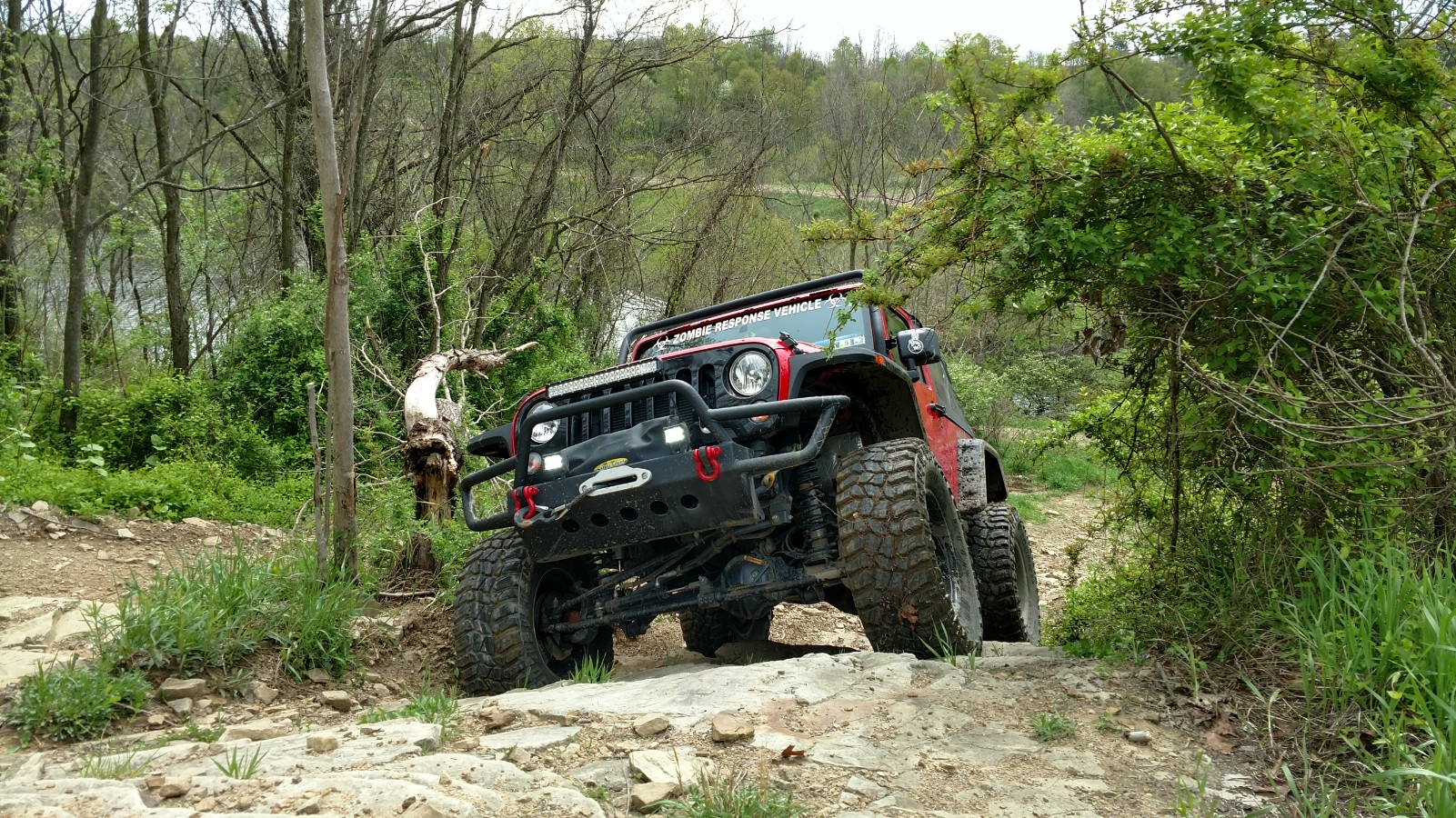

Originally Posted by larry0071
I locked the front with an Eaton E-Locker. My rear Willys package LSD was dead at 16,000 miles, so I bought a Trutrac for the rear. I do run ram assist, so steering is the same locked or not... I love the front locker.Attachment 672103
