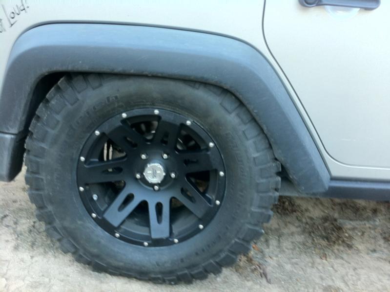

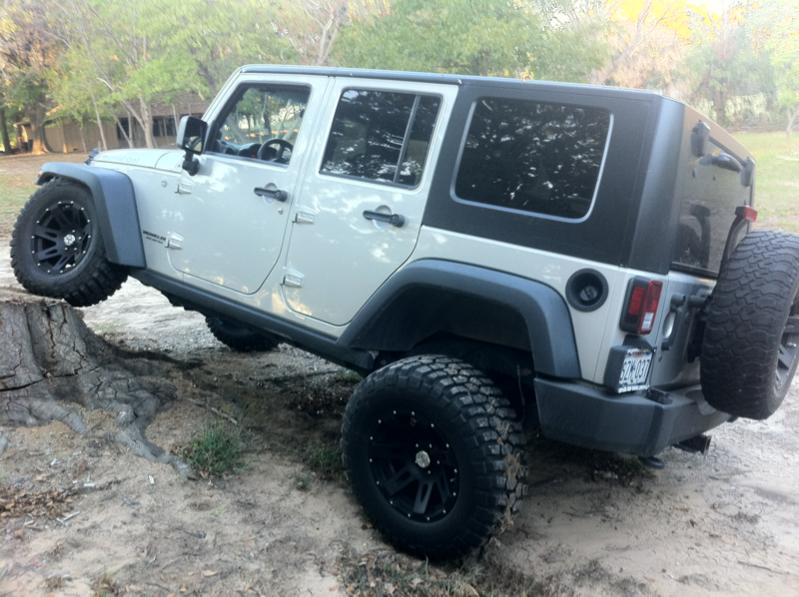

Should be fine for the street. You will rub offroad. The back spacing is similar to my rugged ridge. I have the TF leveling kit and rub when disconnected.
I have the 305/65R16 BFG mt km2s.
Love the tires btw.

Flat fenders, trim stock fenders, or more bumpstops up front will fix it.
