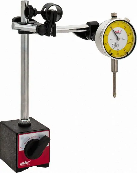

The easiest thing would be if you have a dial indicator like this -
Harbor Freight cheapy probably good enough, but if you can eyeball it, that's pretty bad.
