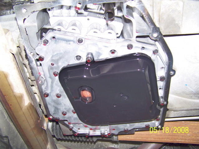

What is the filter like.......like somebody else mentioned, is it just a screen that can be cleaned or does it actually need to be replaced...???
Old Oct 8, 2009 | 06:49 PM
  #28
bostonMA's Avatar
Joined: Jun 2009
Posts: 389
From: MA
It is a fiber filter, similar to the oil. It will run you about $11 at the auto store, a little more at the dealer. I would not bother trying to clean it.
Here is a pic of the filter. It's replaceable, not cleanable.
