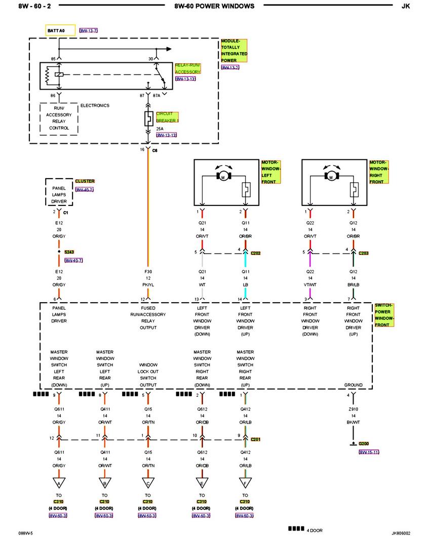

If I got my hands on two more of the front 'auto window down' switches, could I swap them in for the rear window switches and have that feature for the back too? or is there more electronics besides the switch? anyone anyone? Bueller?

Anyone have a wiring schematic?

Here's the diagrams you asked for
ID:	33132   Click image for larger version

Just so you know, the front window switches are not 4 separate switches, but one big switch with the lockout for the rear windows. You'd need to find another Chrysler car (like the PT Cruiser convertable) that has all 4 as auto down switches to even try it.

All vehicles I've repaired that have an express down feature have a seperate module BESIDES the switches that controls the express down feature....Also the switches in the master control normally have different patterns- this is so you can keep purchasing replacement switches from the parts department rather than shifting them around...
