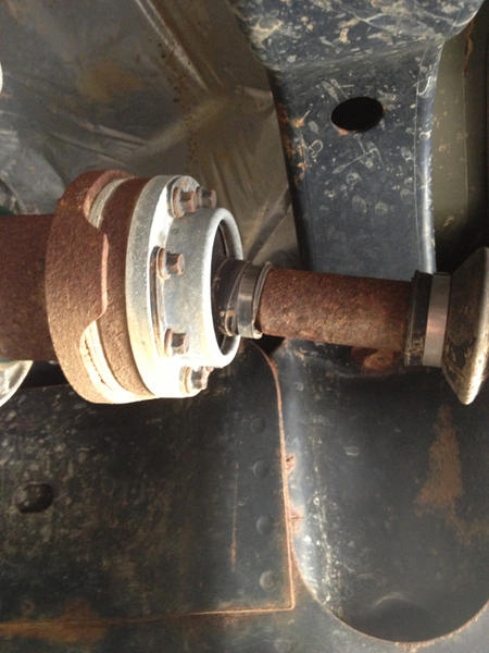

Just noticed this on my rear driveshaft. I only have a 2.5 teraflex budget boost, which is only 2" in the rear. It looks like the rubber boot is slipping out from the clamp

Old Jun 27, 2013 | 01:54 PM
11rubiwannabe's Avatar
Posts: 569
From: CT.
Doesn't look good

Is this level ground? That angle looks harsh!

My garage floor so it's leaning to the passenger side some but for the most part level. I only have a 2" puck in rear! The full 2.5 is in the front

No grease slinging no tearing

Should I just reseat the clamp?

Looks ok to me -- I mean, aside from the clamp being where it is. I'd just go ahead and fix the clamp and see how it does. It's not losing grease, so should still be good to go.
