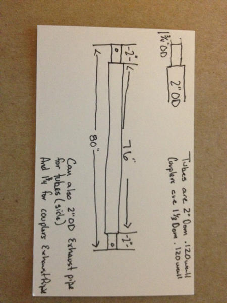

Please see attached photo for measurements andirons you need any further help let me know. I also found out that the DupliColor Kevlar bed coating is an almost exact match for color and texture of the factory powder coating.

Yeah I had to make my own, can't believe that they wouldn't sell a set. I've been in the aftermarket industry for sometime and when they can't send you spare parts like that normally means they don't make in house and have made for them. Anyway they gave me measurements and I was able to make my own.
I reached out to see if anyone had any and no response so bit the bullet and bought the 2" DOM and fabed up a set and actual refined them some and installed a rail to the top so I can mount and dismount and place basket where ever I wanted too.

Ty for the dimensions. I will attempt to get some pieces cut tomorrow.

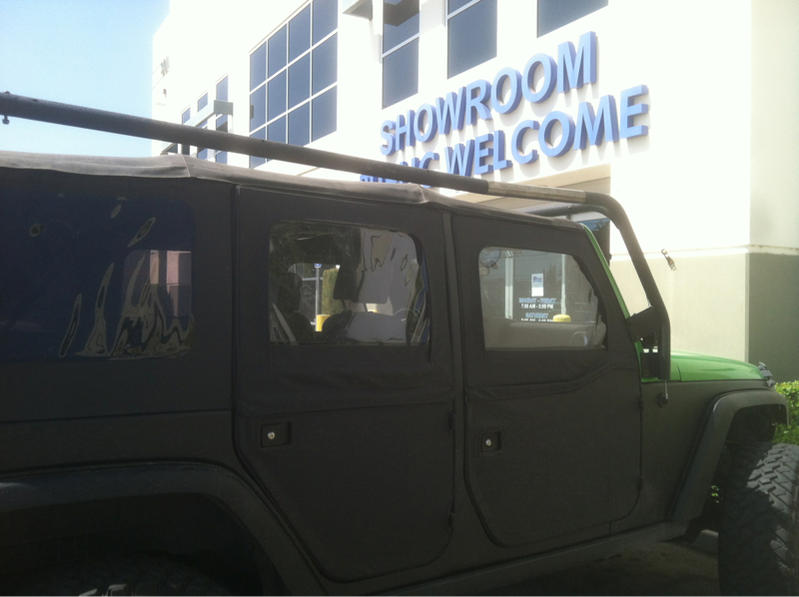

So I decided to try and take a short cut... Fail. I used the dimensions you posted but rather than buying a whole stick I decided to just make up the difference from the short rails and simply extend it. Well, I didn't even think about the fact that it would sag from the weight. Here's a pic of the sag

Lol, so... I got full 76" length cuts now, and extra material that will go to waste. That's what I get. Anyhow, I will throw the 2rails in my rafters and use them in my listing if and when I sell this rack. I'll post pics once I get my new pieces painted
