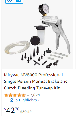

Sorry, "vacuum bleeder" would be what I was referring to -
I see what you're saying about a pressure bleeder. Can't say I've seen anyone use one of those personally. Interesting.
