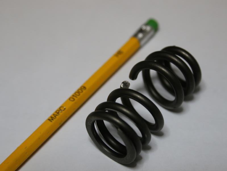

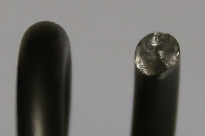

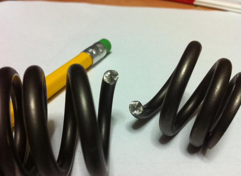

Being it a spring, it is most likely a shear failure caused by fatigue. I attached some photos to help the experts get a view on the matter.

Did they look into the cylinder to check for valve/piston contact? Did they check for a bent valve?
Broken valve springs happen, but I wouldn't say it's all that common. I've been around cars for a long time and have only seen a few.
While 80k miles seems too soon for such a failure, it's somewhat unrelated to mileage. The spring must have had a small defect from the day it was made.
If it were my engine, I wouldn't see this as a sign the rest of them will fail anytime soon.
