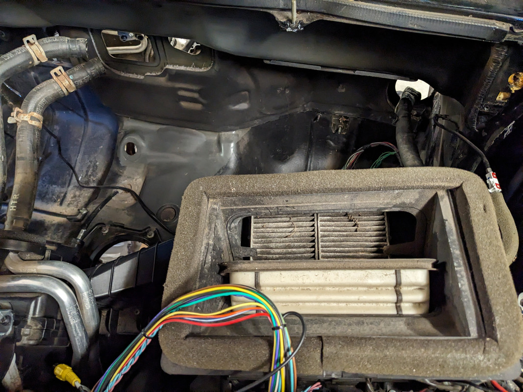

I have a 2015 jku. So I was having issues with losing air flow from the vents and I saw in the forums that it could be debris on the cabin air filter. I took out the glove box and opened the recirc garage door and there wasn’t a cabin air filter installed. I know some models have them and some don’t. Curiously, though, when I felt around in there (looking for trash) I felt what seems to be a filter - but below where the cabin air filter should be. I could only feel the top and I couldn’t figure out how to get that filter out. I can’t find anywhere what that filter is or what it’s for. Any thoughts?
I just had this whole unit apart. Below the cabin filter is the blower motor for the system. The fan vanes might feel like a filter if your fingers are jammed around a few corners and just brushing them.
This is the top of the intake where it meets the duct from the outside. There's a screen under the cowl where the windshield wipers attach, you could check that for debris. The recirculate door is above the filters, there's an actuator on here that can go bad but it should still draw air stuck in either position. My filters were caked with ten years of abuse (never knew I had them) but it still pumped air just fine.
From the front, this is the blower housing with the evap core. The cabin filters sit on top of the blower fan.
This is the housing split open and that's the blower fan, I'd guess that's what you're feeling through the cabin filter hole.

This is amazing. Thank you!!!
