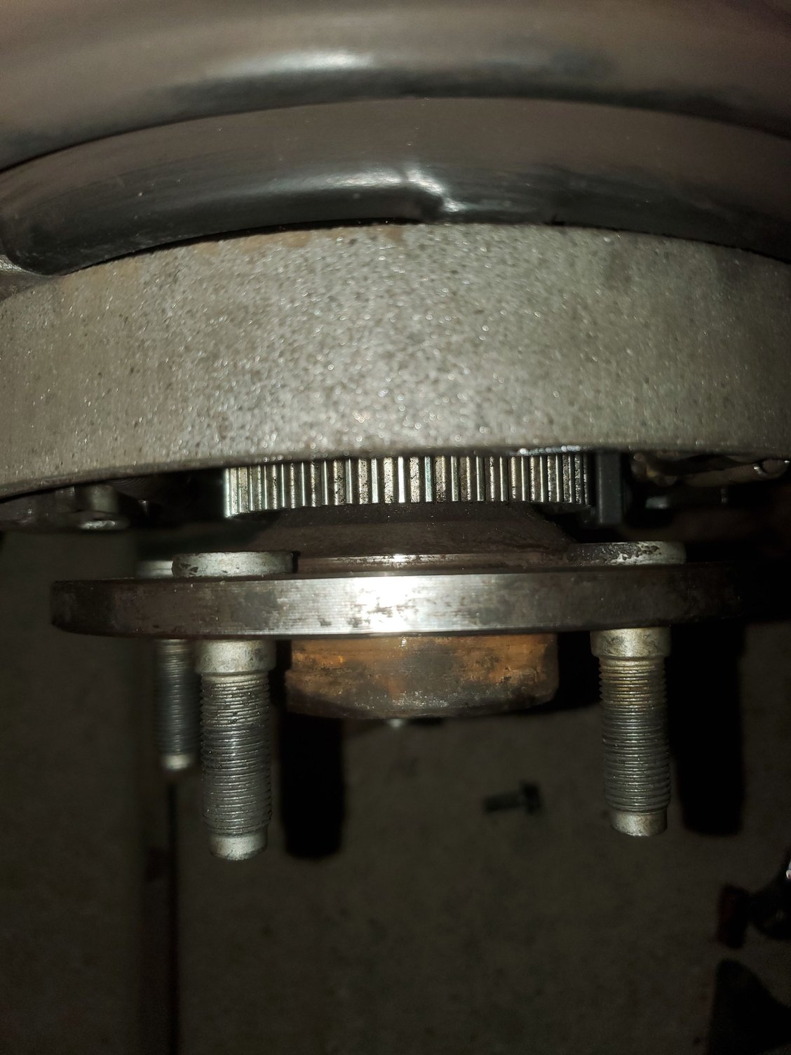

Got a few pictures from different angles? It is terribly hard to envision seals and bearings moving out of place on an axle shaft. that doesn't just happen. Though, it's also hard to think about a rotor contacting that bracket as well. would be interested to see pics from various angles. I guess the more likely thing is axle flange is bent bad. since rotor is secured or axle shaft flange, that bend is exponential the further out it gets.

Old Dec 16, 2020 | 01:55 PM
GilbertB's Avatar
Joined: Dec 2020
Posts: 6
From: Houston, TX
Was able to get home with daylight today. You can see where the bracket is rubbing. I would think if the bearings slipped, it would wiggle in and out but its got no movement.

Bearing and retainer slipped. Wound up removing the axle and saw the gap. Pressed it back in and now it sits right. As much pressure used to press in I have no idea how it worked its way off. We'll see how long it stays put this time.
