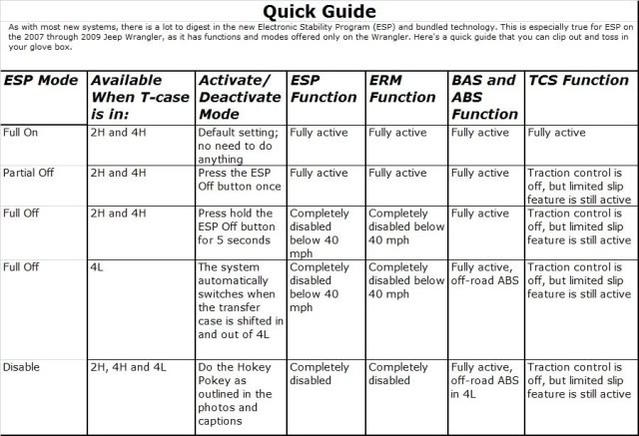

Here is a chart detailing what the different factory ESP turn off methods will actually do. Click image for larger version

Here is the aforementioned traction control hokey pokey kill dance that was mentioned earlier in this thread and is detailed in the final box of the above chart. Click image for larger version
