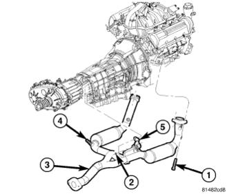

I've got a 2008 JKU w/ automatic transmission. I'm thinking my catalytic converter(s) is clogged and needs to be replaced. Service manual makes it sound pretty simple:
1. Raise and support the vehicle.
2. Saturate the bolts (1) and nuts with heat valve lubricant. Allow 5 minutes for penetration.
3. Disconnect oxygen sensor electrical connectors.
4. Remove the nuts from the front exhaust pipe and catalytic converter assembly to muffler flange.
5. Remove bolts (1) and flanged nuts at the manifold.
6. Lower the front exhaust pipe/catalytic converter assembly (3) and slide out of the mount at the transmission (if equipped).
7. Remove the front exhaust pipe/catalytic converter assembly from the vehicle.
Question --> Assuming I can get these nuts and bolts loose, will the cat assembly/Y pipe slip out as an assembly without removing other stuff? Anyone else done this and have any tips? I've looked for other threads and can't find anything.
