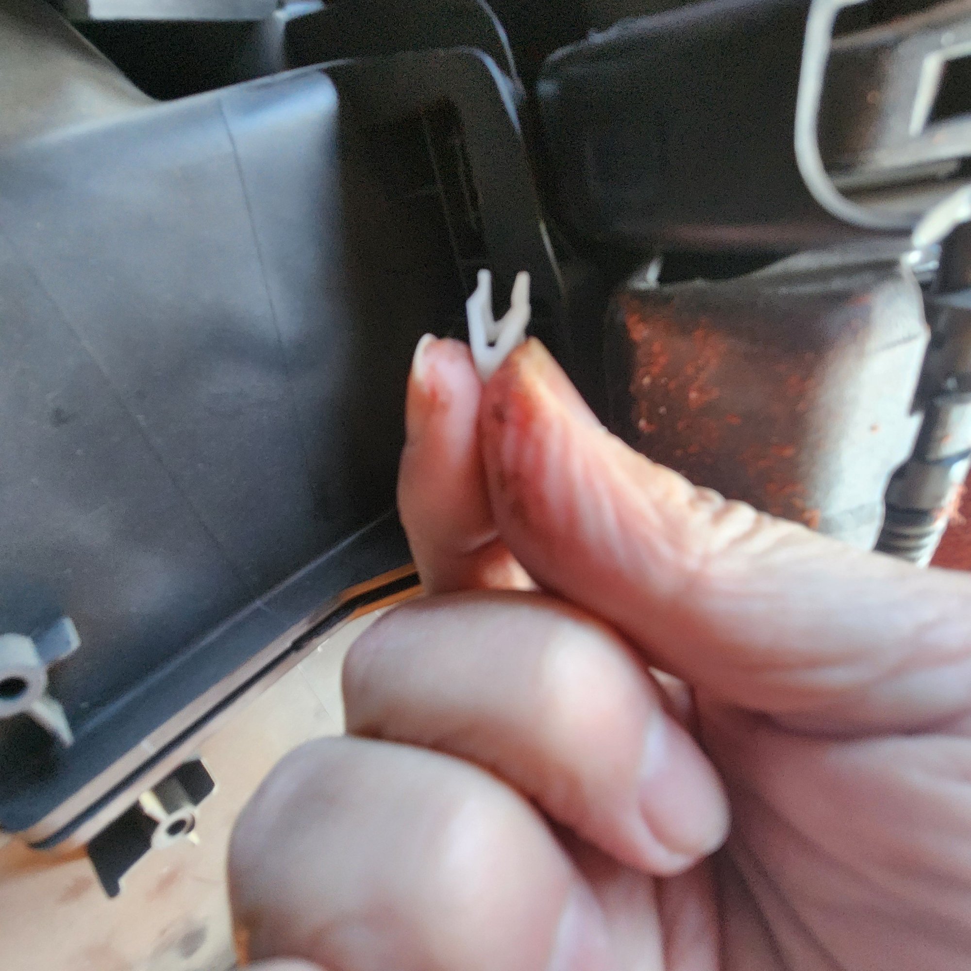

[Sorry for the dog hair in my dusty Jeep.
[img alt="This is the back of the console. Needs only a little pressure to pop off."]https://cimg8.ibsrv.net/gimg/www.jk-forum.com-vbulletin/2000x2000/20250318_111932_3a7d66aa7db97de19d5fc55ef50ccd6c67 d39f6e.jpg
Once its open, find the two  v
Once its open, find the two v" tabs on the underside of the console. These hold on the flange that covers the bolts.
Compare this photo with the next one. First you dont see the bolts, then you do... Flip up the flange to access the bolts.
[img alt="Remove bolts and lid comes off.
Fits back together with no problem. Just reverse the operation."]https://cimg3.ibsrv.net/gimg/www.jk-forum.com-vbulletin/2000x2000/20250318_111104_0ff10aa5f4a1d13906dd7d5aeb8e48112a 7312f9.jpg[/img]
Remove bolts and lid comes off. Fits back together with no problem. Just reverse the operation.
