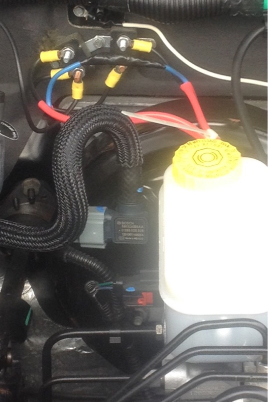

Disconnect the neg terminal on the battery for 15 minutes. Reconnect and see if light comes back on. If so, one place to look is a hose going to the Evap canister by firewall on driver side. Grab that hose and twist it a little bit.
My gas cap light on my 2012 came on a couple of years ago and the tweak of that hose on the Evap canister fixed it.

I've been called worse. Please clarify what made your error message go away - disconnecting the battery or tweaking the hose.
Old Jul 20, 2016 | 07:48 PM
Jeepinjim's Avatar
Joined: Aug 2014
Posts: 132
From: Anchorage, AK
Disconnecting the neg battery cable, again thank you!
