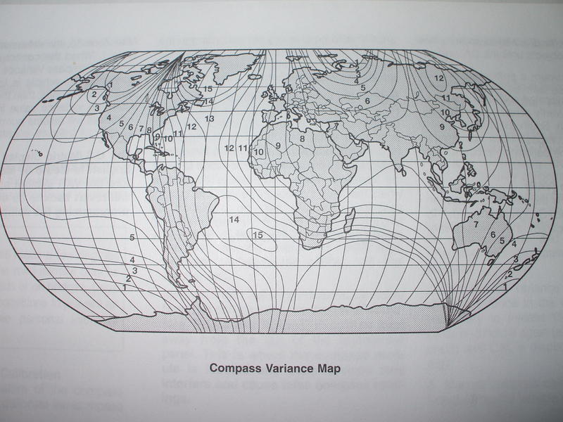

I don't know if the compass is any different on the '10s than earlier build JKs, but here's the instructions from my '09 JK's owners manual (P124-126). The pic at the bottom is the Compass Variance Zone Map that you may need to do the manual calibration (click on it to enlarge):

Compass Variance (VAR) Compass variance is the difference between Magnetic North and Geographic North. To ensure compass accuracy, the compass variance should be properly set according to the vairance map for the zone for the vehicle will be driven. When properly set, the compass will automatically account for this difference.
Setting the compass variance Refer to the variance map for the correct variance zone. To check the variance zone, the ignition must be ON. Press and hold the left button (located on the instrument cluster) for approximately 10 seconds to enter the variance mode and release the button when the VAR symbol appears. The current variance value will also be displayed. To change the zone, press the left button once to increment the zone. The default zone is 8.
After zone 15, the values will wrap around to zone 1. When the correct zone is displayed (per the Compass Variance Zone Map) for the zone that the vehicle is located in, wait for about 5 seconds, then the trip cpmputer will store the variance value in memory and the compass will resume normal operation. NOTE: The US/METRIC display will change from Metric to English or English to Metric to English before the VAR symbol appears, however, it will revert back to its original setting after programming the compass functions."
