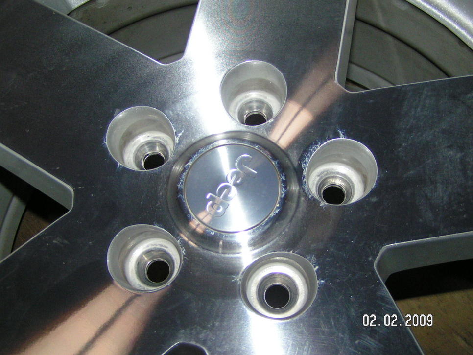

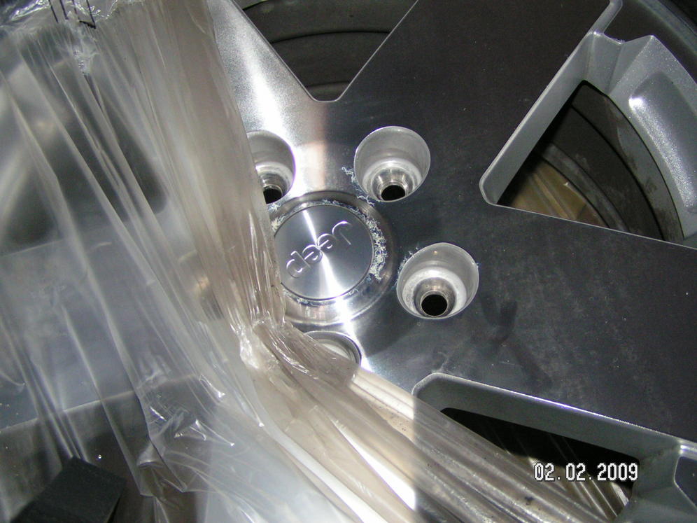

I have a question on the subject of wheel damage here’s what I am fighting, I just bought these wheels from a member, I did not notice it until I was about to put them on that there was corrosion under the clear, I checked around locally the going price to repair each wheel is $90
Any ideas out there? Thanks

Unfortunately, what you're seeing is early stages of corrosion. Only way to repair it is to have the rims resurfaced and cleared. It's an inevitable fact with machined face rims in salty environments. My 97 Cherokee had the same type of rims, and after a few winters with salt on the roads, they started to get like that.

Yeah, you have to remove the white oxidation residue and apply the clear once again to get back to normal....but it will likely happen again..eventually.

It seems really strange that only the 4 on the ground had the corrosion The spare is perfect, I tried the dealer trick it did not take him long to see Sahara Wheels on an X, he seems to think someone used a strong cleaner
, I guess I will just run them for now then powder coat them later.

You can prevent this when the wheels are new by keeping a good coat of wax on them. Now that they are starting to show the corrosion to the clear coat you should just get clear touch up paint and either paint over the bad areas or lightly sand and then paint over them. Either way it should help to prevent further spread and only ~$4-5 for touch up.
Besides the salt and brake dust that scratches the clear of the rims but the BIGGEST reason is the stupid wheel weights are placed on the outside of the rim from factory or the tire shops are lazy & cheap. Always ask the shop for the weights to be placed inside!!!!
Any new rims or vehicle I get...the rims go right to the tire shop and get the wheel weights mounted on the inside of the rim. It may cost a little more but dang it saves the rims in the winter climates where the salt, Calcium Bromide, gravel and sand are used each winter as the weight mounting will scratch throught the clear of these aluminum rims.
If you love the look of the stock aluminium rims and live in a winter climate....invest in a set of steelie rims for winter tires and run your aluminum rims during the spring, summer, fall months.
Only fix for those rims is to removal the clear and get repolished and re-cleared or think about powdercoating. Or use the $90/rim you are going to spend repairing them and get a nice set of rims for the nicier months and use the damaged rims for winter's.
